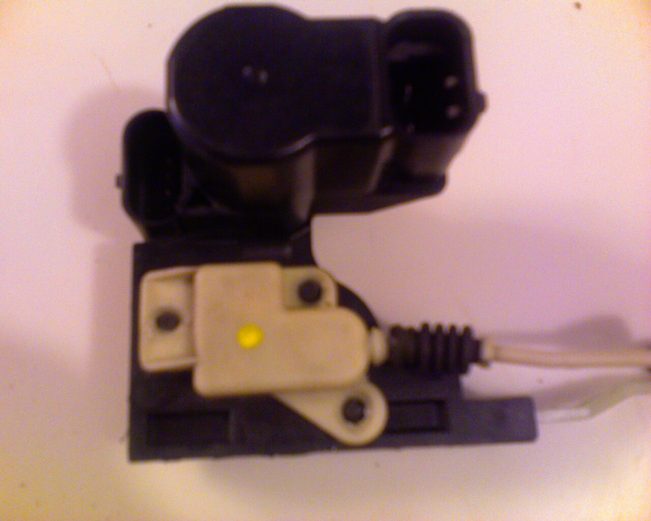

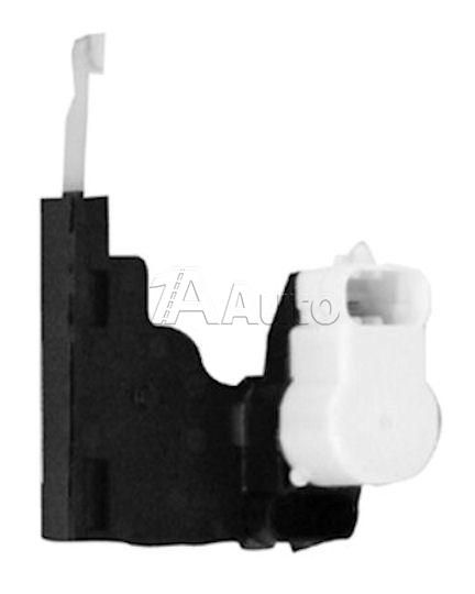

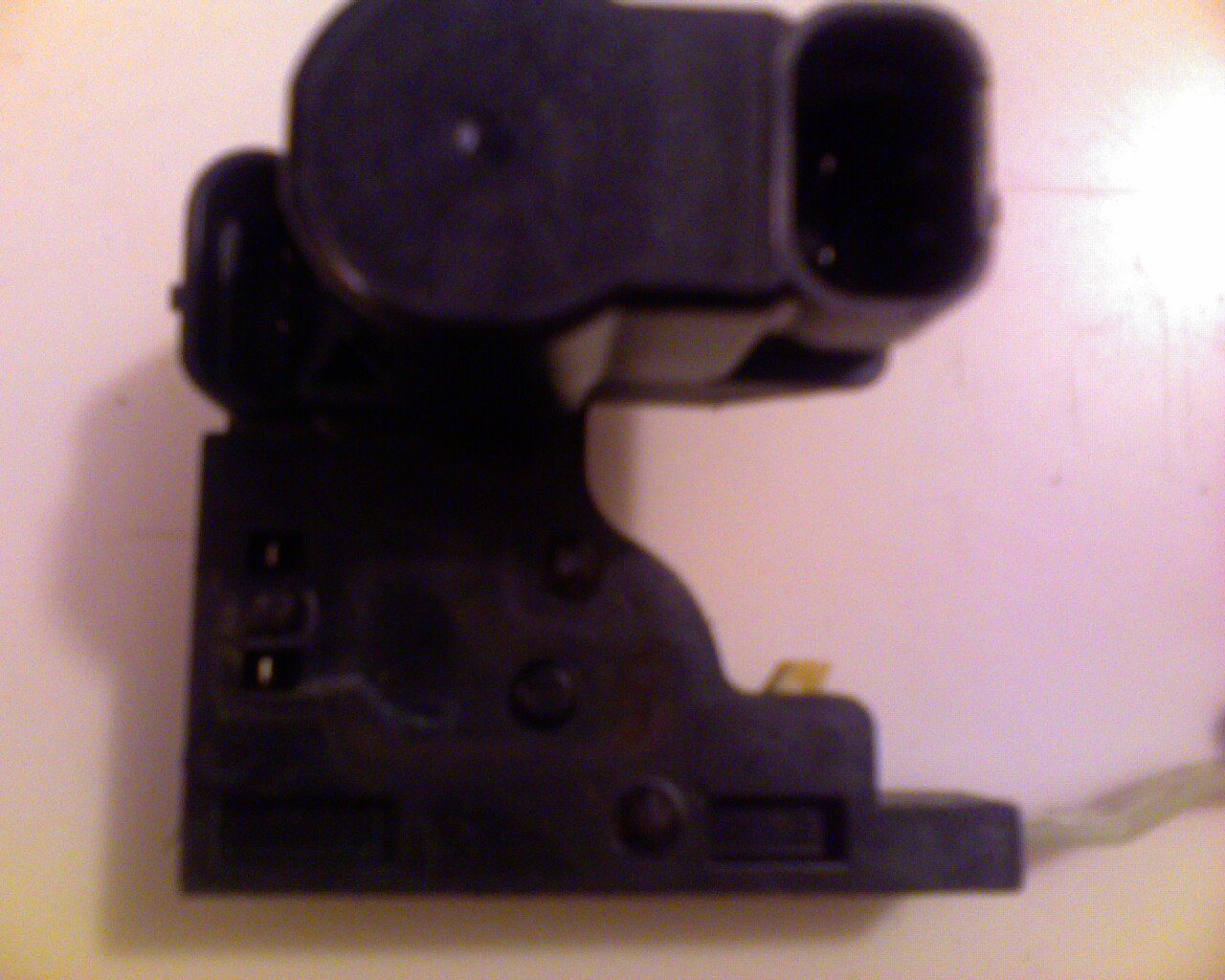

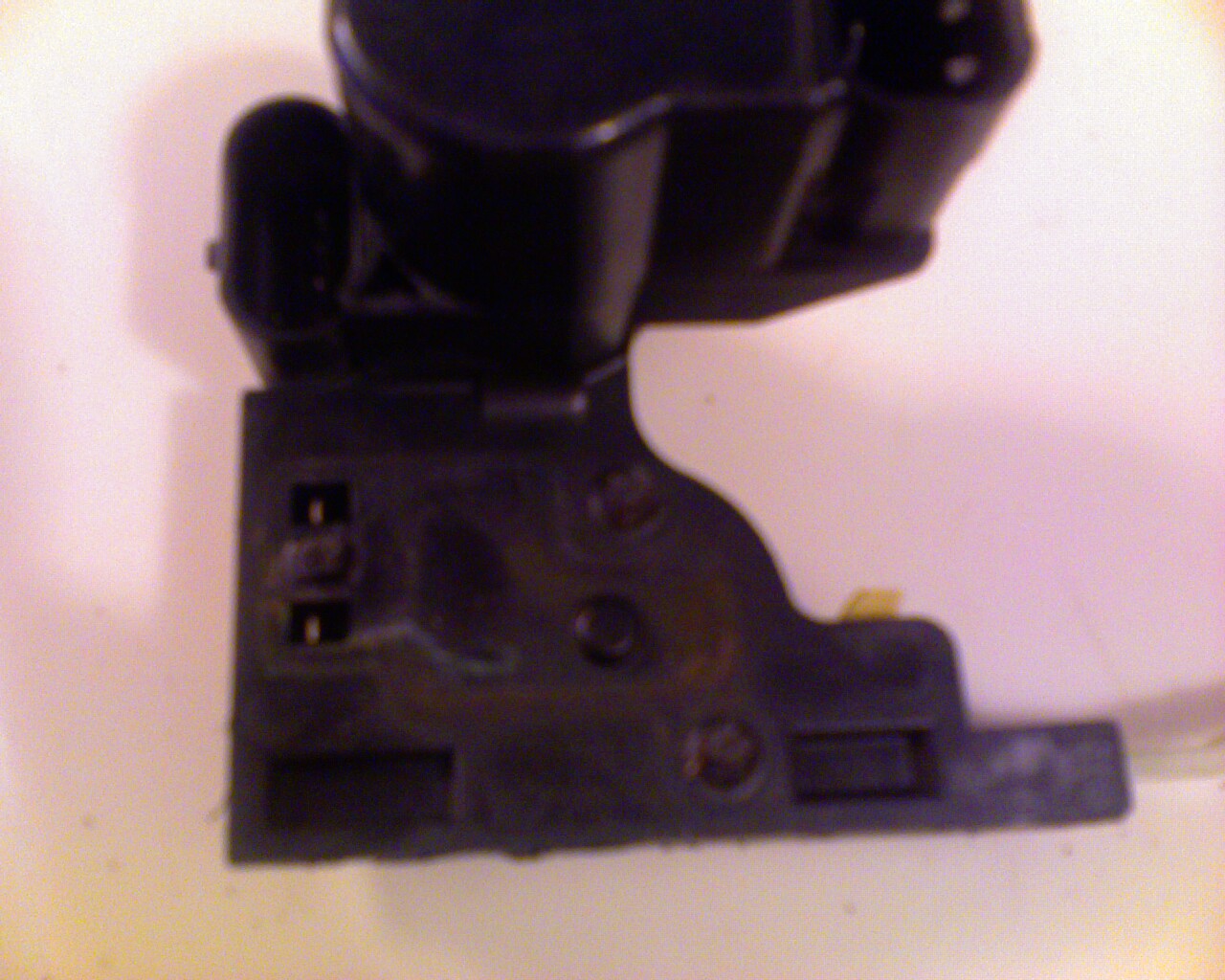

I have a 2000 Silverado 1500 4wd 5.3L. My power locks on the passanger side stopped working and wouldnt even allow the manual locks to work. I took everything apart and found that the actuator was bad. The problem I have now is that noone seems to have a direct replacement. I found numerous sites that carry what they claim is a direct replacement but none of them come with the 2 sensors on it that mine has. I was able to remove both of the sensors from the old actuator and attach one to the new unit with super glue and that works fine but the other sensor has 2 small prongs that go into the face of the unit. It was held on the old unit by melted plastic of some kind. I think the sensor is for the theft deterrant feature (since it no longer works with the new part installed). Trying to attach a sample pic of new part and old part.

If you have trouble finding the right part the difference is apparently whether or not it has the sensors for the illuminated entry. The pictures of the new part I posted are of one without the sensor. If you need with the sensor you have to replace the whole assembaly (probably easier to do that anyway but more expensive.)
