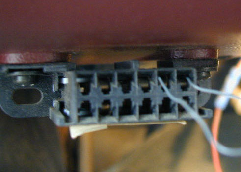

1. Locate ADL port below dash.
2. Insert paperclip or similar wire. (see photo)
3. KOEO (Key On Engine Off) watch SES light.
4. SES (check engine) light will blink out codes. It will flash, then short pause, then flash again, then long pause between codes. Example: flash, (pause), flash, flash (long pause) is code12 for no RPM. This code is always present.
Example 2: Flash, flash, flash (pause) flash, flash, flash, (long pause) = code 33. The computer will continue to scroll through the codes and generally begins and ends with 3 code 12's, with important codes being shown in between.
