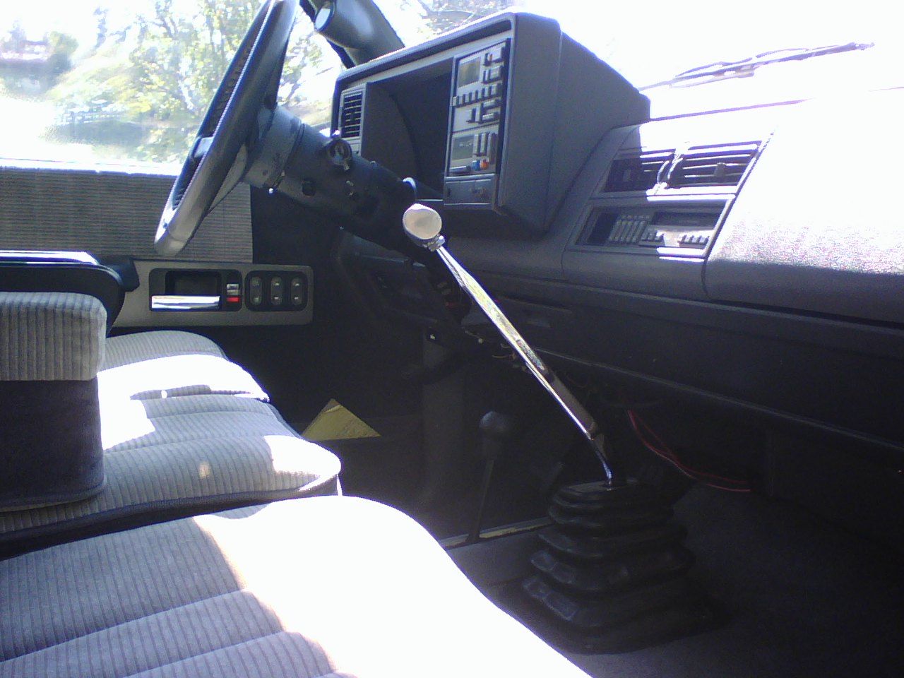

My radio shorts off, always loses presets, sometimes loses EQ settings. Playing radio, hit scan, display goes blank, radio & EQ goes off, then clock comes back on in a min, eq. loses settings.
Is this a common problem and what is the fix? It isn't a standard din size so it won't be replaceable.
This is the 4 speaker with cassette/EQ setup.
Thanks

There is a wire chase that runs under the tape EQ portion which was notorious for chaffing on a metal support and shorting out, you may want to pull your glovebox and see whats back in there. Back a few years, the Crutchfield gang carried a replacement which actually went in where the factory head unit is, but I do not know if they do anymore. As mentioned, the way to go new is put it where the EQ/Tape unit is. Nowadays you can practically get a bigscreen TV and DVD for that spot. :D
