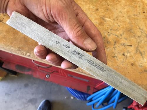

The end of cabin filters with the 02 year is as close as I could find, so I got a filter for a 2002. I have a stock 2005 Suburban 1500 2wd. There's a tutorial somewhere on here, and some guy actually sells the retrofit kits so you don't have to buy a GM bracket or make your own. I attached photos here so anyone who wants to duplicate it can do so, but unless you really enjoy being in your garage, it'll probably be easier to buy the kit. It's on some Diesel forum. Just Google Chevrolet SUV retrofit kit and it will be one of the first few.
On mine, I cut out the bottom of the plastic housing like the tutorials show. I bought a wix filter (actually two filters in the set) for $20. You have to have a bracket on the bottom with some kind of foam tape to make a seal and keep the filter from falling out. I used a piece from an old wheel barrow frame. It already had a length-wise bend so it gave it strength to not bend, and it was just the right width. I had to do a bit of grinding and bending of the end of the bracket so it would fit into the hole at the back of the filter and hang on. It needs a little lip on the end to keep the end closest to the firewall in place. I had a terrible time getting the second filter in, so I cut off the insulating tape on one side of it (the side that butts up against the other filter) so it would fit. It was still a tight fit, but it worked and there was no gap between the filters. I used a piece of the filter box to go between the two filters when I was sliding the second one in, and having that slick surface made it easy, then I just pulled out the piece of box. I cut the piece of tape I had cut off lengthwise and taped it to my bracket. I had to drill a hole in the bracket and find a screw of the right size to go into the factory screw hole that was used for the 02 and prior years. GM left all the formed plastic the same, which is why it was possible to put a filter kit in the '05. I painted the bracket blue so you can see how it worked.
