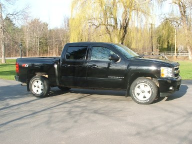

Im going on vacation so a good time to send Justin my ecm, tcm. I'm still on the fence about the afm being on or off. Please advise, my truck does see some highway, less than 50%. My work commute has a lot of hills. Not a true daily driver, rather drive Grand National in good weather. My wife does drive highway to work, she drives 30 miles each way to work on level highway, maybe 8 times a month. Total milage for a year maybe 8000 at most. Truck is nbs 07 crew ltz, 5.3. Any other notes I should send him in my notes about preferences. PM are ok if you dont want to put out there for everyone.
