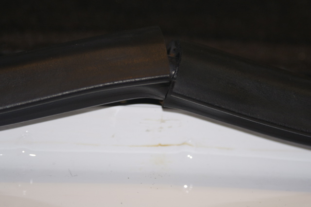

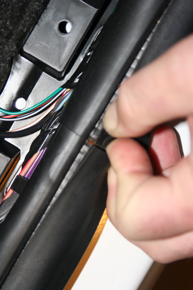

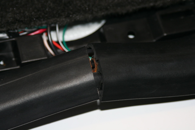

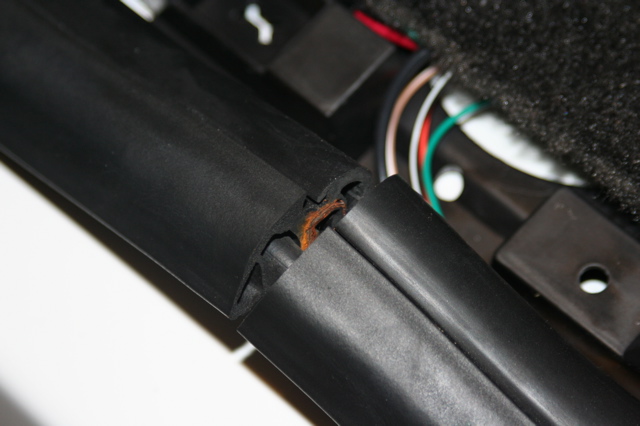

Matt09SLT Posted February 7, 2010 Posted February 7, 2010 yep; it's the metal strip inside the weather strip. Here's some pictures from mine, 09 Sierra less than 12K miles.
Zembonez Posted February 7, 2010 Posted February 7, 2010 That weather strip is not a formed part. It's off of a giant roll and cut to length. I guess they didn't count on it rusting? Mine are fine now that they have been sealed.
Matt09SLT Posted February 7, 2010 Posted February 7, 2010 I think i'll just silicon them all and call it a day.
