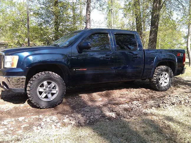

brokekid Posted March 29, 2010 Author Posted March 29, 2010 Got rid of the 24s and threw some Nitto Mud Grappler 33s on my stocks. Now i can finally go through a little mud without sliding, the lo pros. just werent doing the job..lol..Loving the Nittos except for they rub a bit when I turn so now I'm thinking of adding some spacers and a body lift, hopefully that'll fix the problem. Thanks for yalls help!
Tdeaux45 Posted March 29, 2010 Posted March 29, 2010 Wheel wells look a little stuffed, a BL would look great and bring you back into proportion. I like keeping the stock wheels. Looks good even if you leave it like it is.
sab316 Posted March 29, 2010 Posted March 29, 2010 Looks good man.. I don't think it looks too stuffed... Even though I hate the Mud Grapplers the truck looks good with the stock and 33's
brokekid Posted March 29, 2010 Author Posted March 29, 2010 Thanks for the comments guys...why don't you like mud grappplers sqb316?
