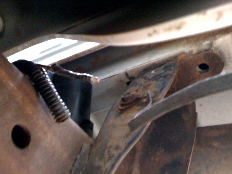

Ladies and gentlemen, let me introduce you to G403, and G302. This contains the fuel grounds, and the fuel filter ground. I started chasing down all the stupid things I could think, and while checking this ground i found it broken, i figure it was about toast, and then when i got the tank back up it gave way. you can see the terminal ring broken. Think i found the problem!
