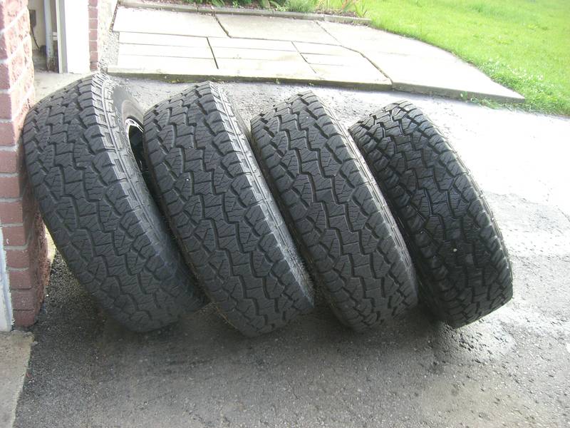

2008 silverado extended cab. have the leveling kit to go on with the tires and rims. a guy is selling them locally and just looking for what you guys think? The tires are 285.70.17 hankook dynapro AT-M
Rim bolt pattern is 6 x 139.7 (thats what my truck is right)?

i think they look good on blue. next thing is they came off a toyota FJ cruiser, the bolt pattern is the same and i think the offset is +12. is that good does anybody know. and what about the axle center. how do i know if they will fit exactly??
If lug pattern is the same I wouldn't worry. +12 offset is pretty close to factory offset. They won't be hub centric, but that's no problem, they'll be lug centric like mine are. Although you can get shim rings installed if you're anal and think your lug studs will break.
so they will fit over my hub no problem? i wouldn't be anal about the lug studs. i just don't want them to stick WAY WAY out and i want them to fit over my hub. isn't factory offset +31?? + 12 seems pretty far off that
well, the toyota hub is usually larger than the chevy one, so it will fit over your hub I believe. But it would be best to just measure before you buy. Hell, my rims are -18mm, so +12 should be fine.
ok thanks for the great info, i will get him to measure the hub. but how will i know what size mine is with the rim on my truck?
The spare tire is the easiest way. As long as what he says the hub on the rim is bigger or the same size as the spare it will work. Being an aftermarket rim (being universal and all), I'm 99.9999999573765723659% sure the rim WILL fit. considering it is the right lug pattern. :thumbs:
