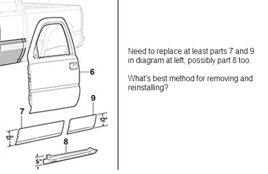

My rocker panels are rusted and I would like to replace them, never done this before. Question: When I purchase these panels, what's best way to remove old panel and best way to put new one in?

The repair will involve cutting the old one off with a cutoff wheel. The new one will need welded on. Then smooth the welds down with a grinder and apply body filler and sand smooth.
Pretty extensive body work.
Its not too hard the old man does a good bit of body work like this and probably the hardest part is getting everything lined up and making it look like it was never touched.

I'll do work myself as I have welding experience, and want to try my hand at restoring body work due to our salted winter roads...
I'm assuming the cutoff wheel would be a high speed Grinder (28,000RPM)...

I would be really carefull with a shearing type tool as it might distort the remaining metal too much. Body work really is not that difficult as long as you pay attention and align everything the best you can. Read as many online tips as you can and maybe watch some youtube videos. If you can weld thin guage metal you should be good to go. Try to use as little body filler as possible.
