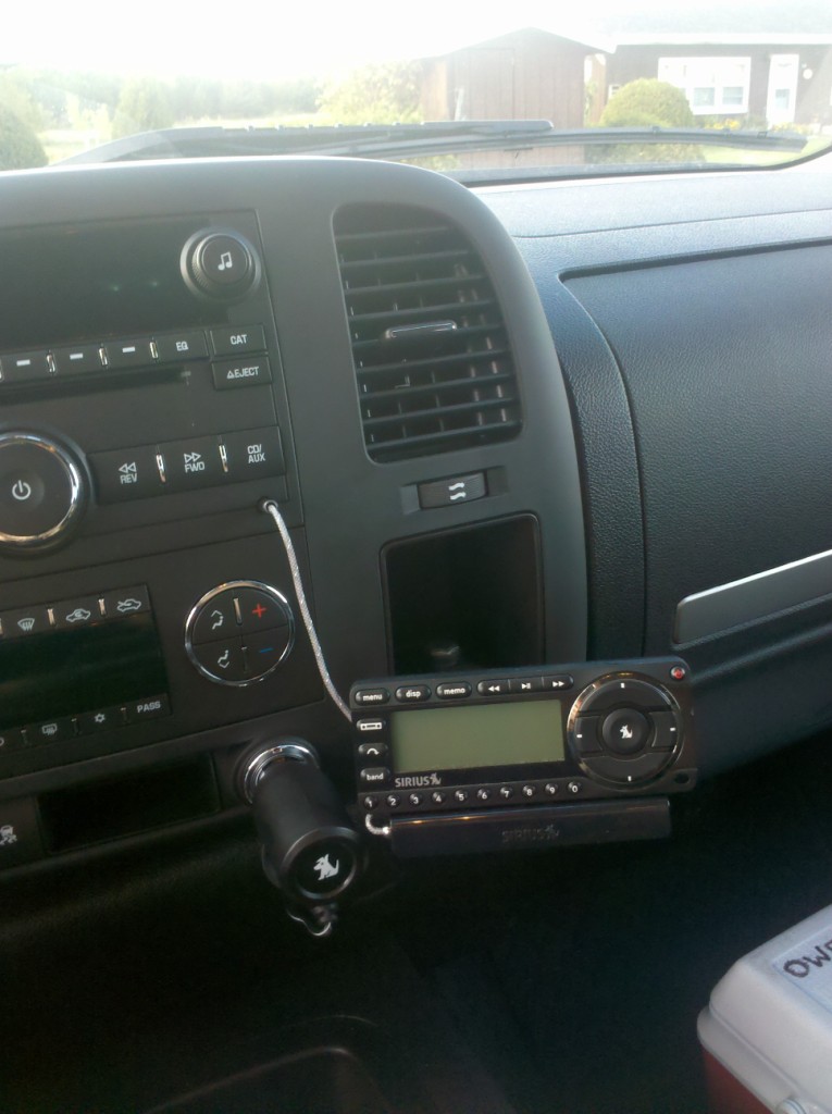

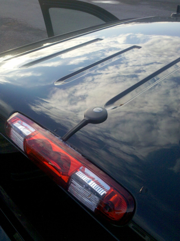

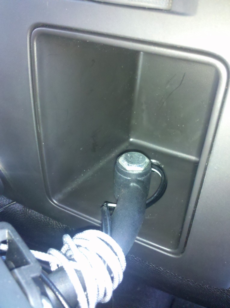

I had a Sirius Starmate 5 Dock and Play radio sitting around from my Chevy and was paying for it so I figured I might as well install it into my Sierra. I was getting fed up with the reception from XM and really like the artist alert functions as well as replay. I used the factory windsheild suction mount and modified it a bit and utilized the 2 holes in the dash pocket where there was a rubber piece inside. (See Pics) I ran the antenna wire along the headliner and out the 3rd brakelight and put some clear silicone around the wire to prevent leaking. (See Pictures)

I think it's a good location to mount it.
Antenna on roof.
Close up of the mount.

Yeah it was custom. All I did was turn the windshield mount sideways and bolt it into the dash. Came up with the idea myself.
