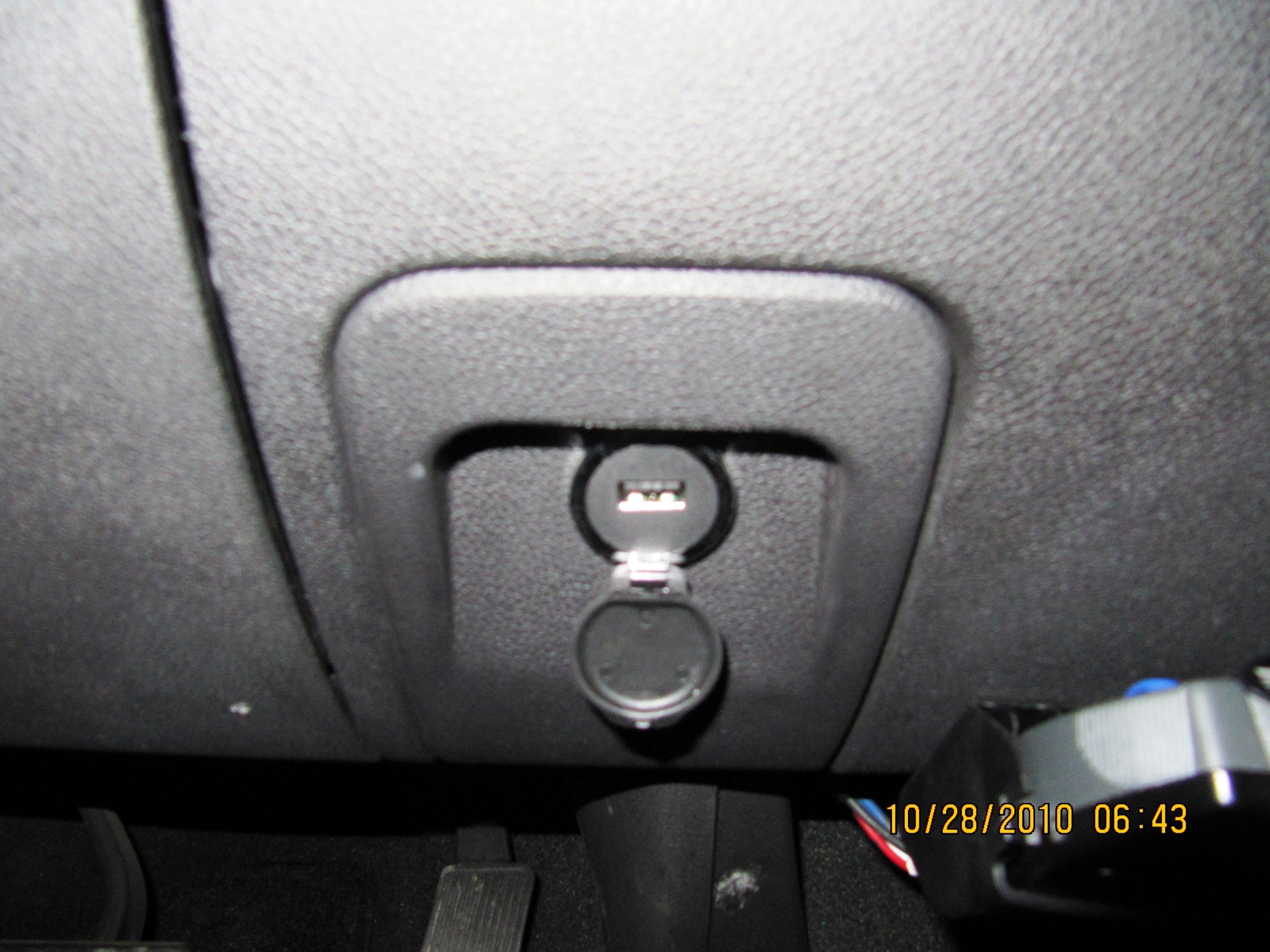

Here the pics of the usb radio I installed in my 07 screen is dirty after install but you get the drift of how it look and works.

No give us some insight on HOW you did it :dunno: Programming issues? Or just straight across swapped radios? Any complications with anything like phone, or OnStar?
Clean install I like it. Did you get a replacement factory radio with the USB input?
yes, bought it off ebay.

Brought it to my dealer for programming no problems, very easy straight forward swap plug and play.
Then add a mini b male to male 6' usb cable and your done.
Usb receptacle was $30 dust cover $5 and 6 disk CD changer with usb $65.
Had no effect at all on my onstar bluetooth that I install.
I am very happy now this is the way these trucks should have come out in 07 with bluetooth and usb from the factory.
The factory steering wheel controls all work as they should for the usb and bluetooth.

I GOT THE SAME USB STUFF. BY THE WAY HOW DID YOU GET THE RING AND COVER OFF??? I GOT THE INSIDE POWER PIECE OUT OK BUT CANNOT FIGURE OUT THE COVER PIECE. DID NOT WANT TO BREAK IT.
not sure what your talking about? If you have the power outlet out the cover should come out easy. I ordered new parts and left my two power outlets alone and put the usb in the ashtray
