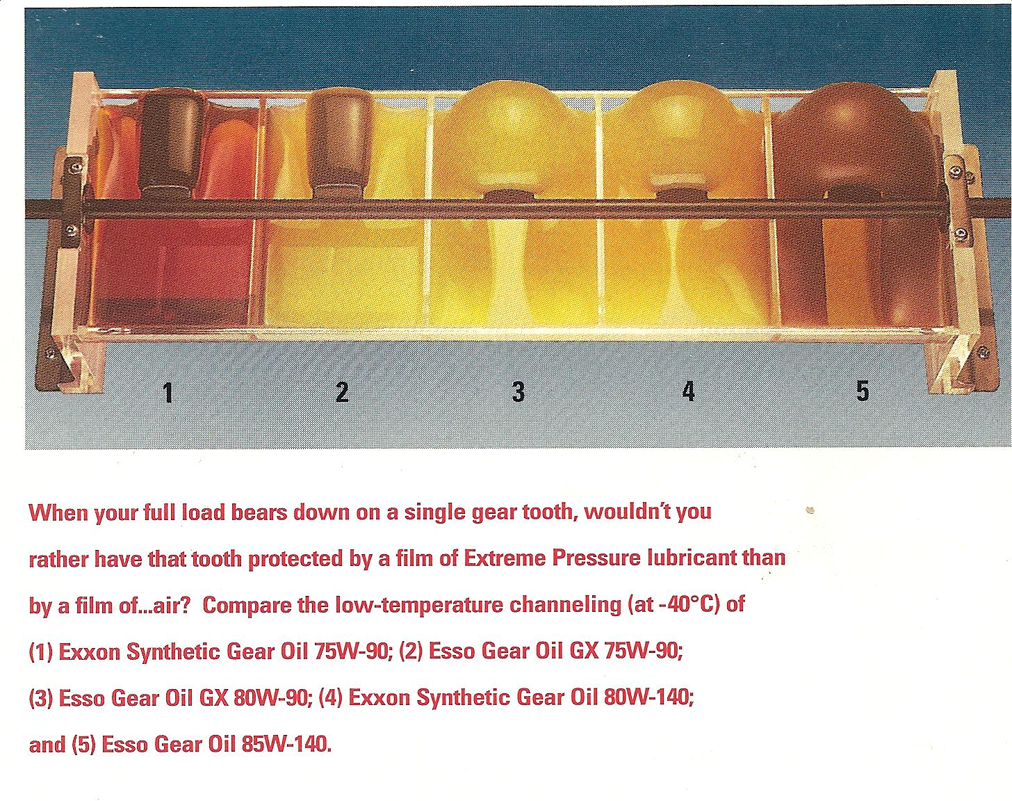

When I get the chance I'll post some scanned pics from an Esso brochure about engine oils & gear lubes @ low temps.
I've used 0W30 and 0W40 and there are only benefits and no adverse effects (other than cost difference for synthetics).

edit- those scanned brocures are interesting, can you go from synthetic oil back to dino?
