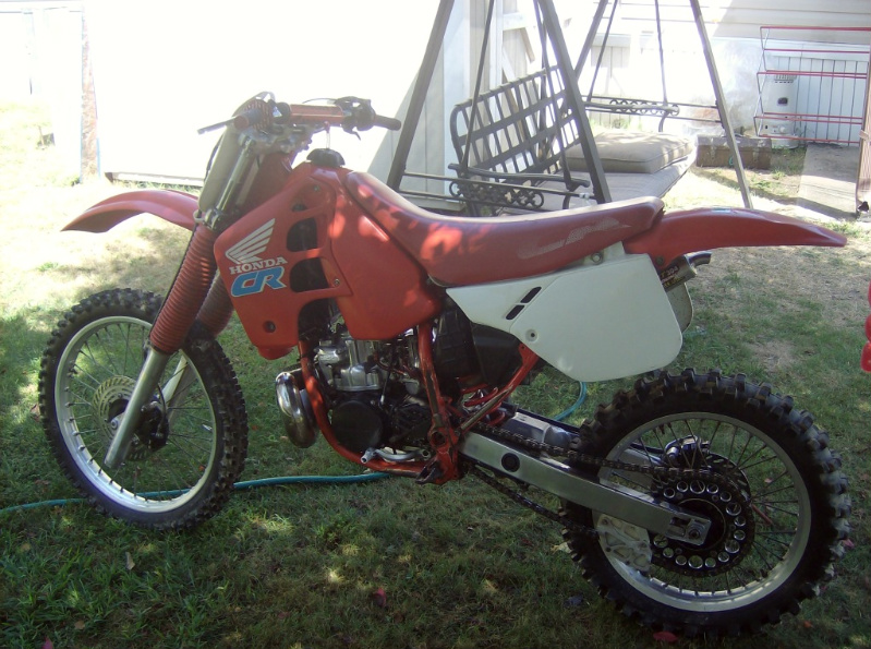

Got any pics of your cr? i had a brand new yz 250 and i got it all set up for the track (alot of money and time went into that bike) and once i got everything perfect it got stolen. Insurance wouldnt do shit for me. took them 3 months and they only gave me $5000. so what ever i owed came out of my own pocket. but i bought a brand new yz 450. only got about 5 hours on it.
front fender looks weird because it was leaning on a rm250 for the longest time.this pic was in the summer time shes nick named the "trouble maker" for a reason.

clean looking bike. I just got the one pic of my 450. I just ordered a dr.d full exhaust, jd jetting and i got abunch of stickers to put on in this spring. This is when i first bought it. It looks a lil different now.
