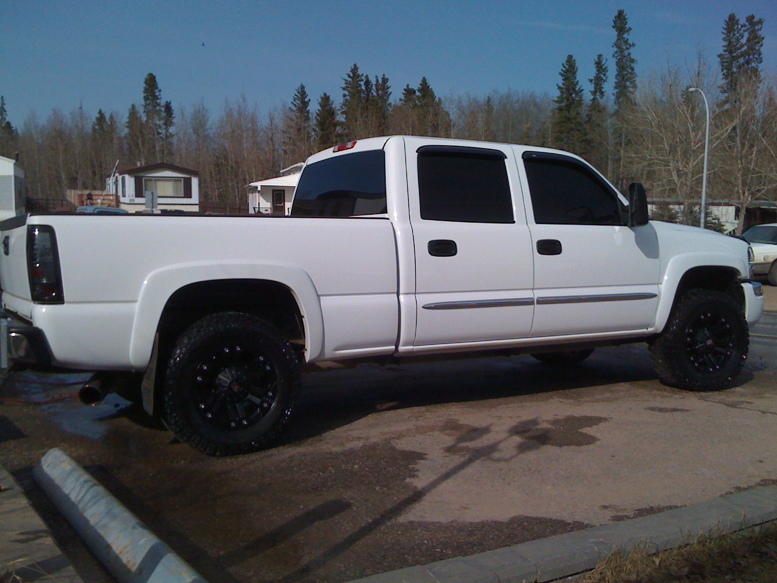

i own a 06 1500hd, good truck...its a 3/4 ton. they have a 14 bolt semi-floating rear end. ive towed over 12 000 pounds with mine, i have firestone ride rite air bags tho. i have a decent tow/93 octane tune too...does the one you want have the big mirrors like mine?? they are nice trucks...heres mine
