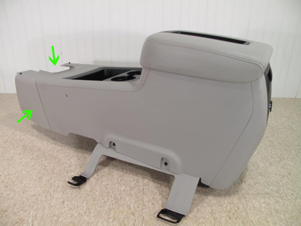

The console I have is from a 2010 2500. I got it for $425 on ebay last March (the pic above is from last April). The seller was B and B Wholesale...at the time, they had a bunch of this same console. Aside from colors and rear audio controls, there are basically two types of consoles...long and short. The short version is, by far, the most common and is for trucks that have the "upscale" dash with the extended center section. The longer version is for the "true truck" dash and is what I have and what you will need if you want the setup I have. It shouldn't matter which vehicle the console comes from (1500, 2500, etc.). I checked ebay almost daily for a year and a half before I found a long version in ebony. I don't know if the newer ones are different. You could PM moderator MS3DALE (Rich) and he could tell you...he's a Parts Manager at a dealership.
Here's a pic to show you how to spot the short version. The short one will have a square notch on the top front and the front trim will be a separate piece. The long version...the one you need for a TT dash...will be all one piece and won't have that large notch.
