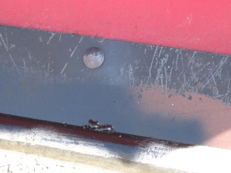

I will try and get pictures of this but just been to busy with a new house and all. It really is simple and slick, once you see it and I couldn't believe how well it worked until I saw it in action. A good friend of mine that owns a farm devised it to plow all of his gravel drives, around the farm, without displacing all the stone/gravel. I grew up in farm country but still missed picking up on some of the fab skills that the farm boys have. :D
they are not great but have a few pic's
I will try and get pictures of this but just been to busy with a new house and all. It really is simple and slick, once you see it and I couldn't believe how well it worked until I saw it in action. A good friend of mine that owns a farm devised it to plow all of his gravel drives, around the farm, without displacing all the stone/gravel. I grew up in farm country but still missed picking up on some of the fab skills that the farm boys have. :lol:
Yup, the one's my friend uses are just like that. I guess he's not so ingenious after all if other people are using
it too! LOL. :D
