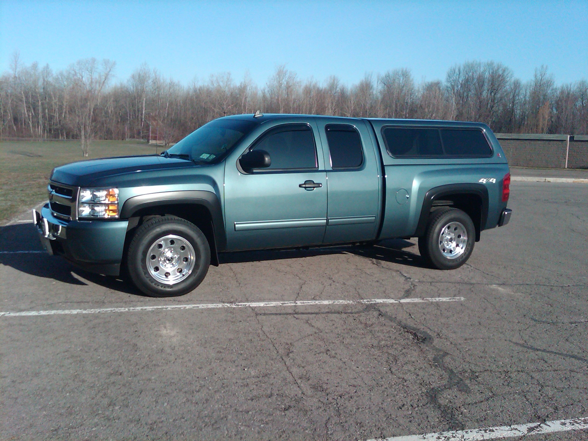

just install a 2" BDS leveling kit yesterday. The shop said these would fit ok, however still uncertain, i've seacrhed and see alot of threads say they wont rub, i have the american racing baja rims, they have a different back spacing than the factory the wheels stick out past the fender about an inch with the 265's
here are the specs on the stock rims vs American Racing Baja
stock 17 x 7.5
ar 17 x 8.5
anyone running 285's on the Baja rims? thanks
here is the truck before the leveling'
