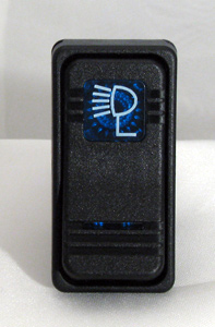

but the dash in the GMT900s (Avalanche) doesn't have much in the way of space for auxiliary switches or whatnot, like the GMT800s did.. no empty spaces anywhere to put the other 3 switches.. where does everyone mount their aux switches, and do you have pictures?

switches are too big..
I am considering something like this:
for the switches and the HAM radio, problem is then I lose all my storage space for my phone, and misc crap..

I would second mounting them in the tray between the dash and the counsel.I have mine mounted between the cigarette plugs but since you already have buttons there that won't work
It's not finding a place that's hard, it's finding a place where they won't stick out so much.
yeah, where they look nice and not like a $2 hack job on a $50K truck..
some one on the Mopar forums I admin suggested I wire in a remote control unit, then all I will have to have is a key fob with 4 buttons..
http://www.ledssuperbright.com/4-channel-w...ss-switch-p-168
yeah all the OEM buttons I never use..
do you have a picture of yours? it actually might work to move the factory buttons since I never use them (park assists off, electric pedals, and traction control (ok I use that one))
I can't find a pic of it at the moment but if you need one I can snap one. I have the All Terrain with the center concole. If you have this interior forward of the cup holders is a narrow flip up cubby the same width as the cup holders. I removed the factory insert, bought a sheet of ABS plastic from ebay for like $5, cut it to size and have a nice new switch plate. I like it because I can just close the factory cover and everything is hidden.
