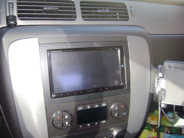

Hi Everyone!
New to the boards and wanting to make sure I have everything I need for the 9960 install on my 07 Avalanche w/ Bose and w/o RSE. I wish to keep all factory chimes and stock steering wheel controls and this is what I have so far for the adapters I need. Am I correct? Also, what would I need for this HU to work with my existing factory XM?
PAC OS-4 Radio Replacement Interface for 2006-2007 GM LAN Factory Radio
PAC SWIJACK Steering Wheel Remote Interface
Kenwood KCA-IP301V iPod Video Direct Cable - I have an iPhone 4
Also looking at Rear View Camera options which will work with this HU. CMOS 200 or 300? Or any other ones I should consider?? Thanks for all your help!

I have the same radio in my 2011 Sierra right now and Love. Everything you have listed is what you need for the install other than I didnt see a face kit. The OS-4 allows you to keep your factory xm. The only bad thing about it is that steering wheel controls are the only way to control the channels on the factory xm. So I opted to go with the Sirius add-on as they discontinued the xm module. But the only other thing that I suggest is to cut out the back of the dash so the radio sits furthe back into the face kit. It sticks out over a 1/4 inch without doing this and it looks awful IMO.
As for the backup camera I have read that the 300 does a lot more but is fairly expensive. I just use my factor rearview cam on mine.
