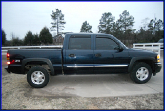

RJNehus Posted April 20, 2011 Posted April 20, 2011 So I've read a few post on here about torsion bar adjustment and decided to go a max of 2''. The pic i put in is of my truck before i did any adjusting. I raised both sides 1.5'' and the passenger side bolt is maxed out?? The driver's side bolt still has about .5-.75'' of adjustment left. I did the driver's side first. The truck is near level, maybe slightly lower in the front. I just purchased the truck, but the guy i bought it from says he didn't adjust anything and with the rake i believed him. Also, does anybody know the height of the stock rear blocks? Does anybody have any suggestions? thanks RJ

RJNehus Posted April 20, 2011 Author Posted April 20, 2011 Guys, thanks for your input. I do want it sitting high and do care about my front end parts, that is why i was going to do a max of two inches. The way it sits now is fine as far as being level, but it worries me that the bolts aren’t even close to having the same adjustment and that one side is maxed out. thanks RJ
Stevens03 Posted April 20, 2011 Posted April 20, 2011 Guys, thanks for your input. I do want it sitting high and do care about my front end parts, that is why i was going to do a max of two inches. The way it sits now is fine as far as being level, but it worries me that the bolts aren’t even close to having the same adjustment and that one side is maxed out. thanks RJ Thats normal for the sides to "settle" differently. I've seen it many times. Don't stress it.
