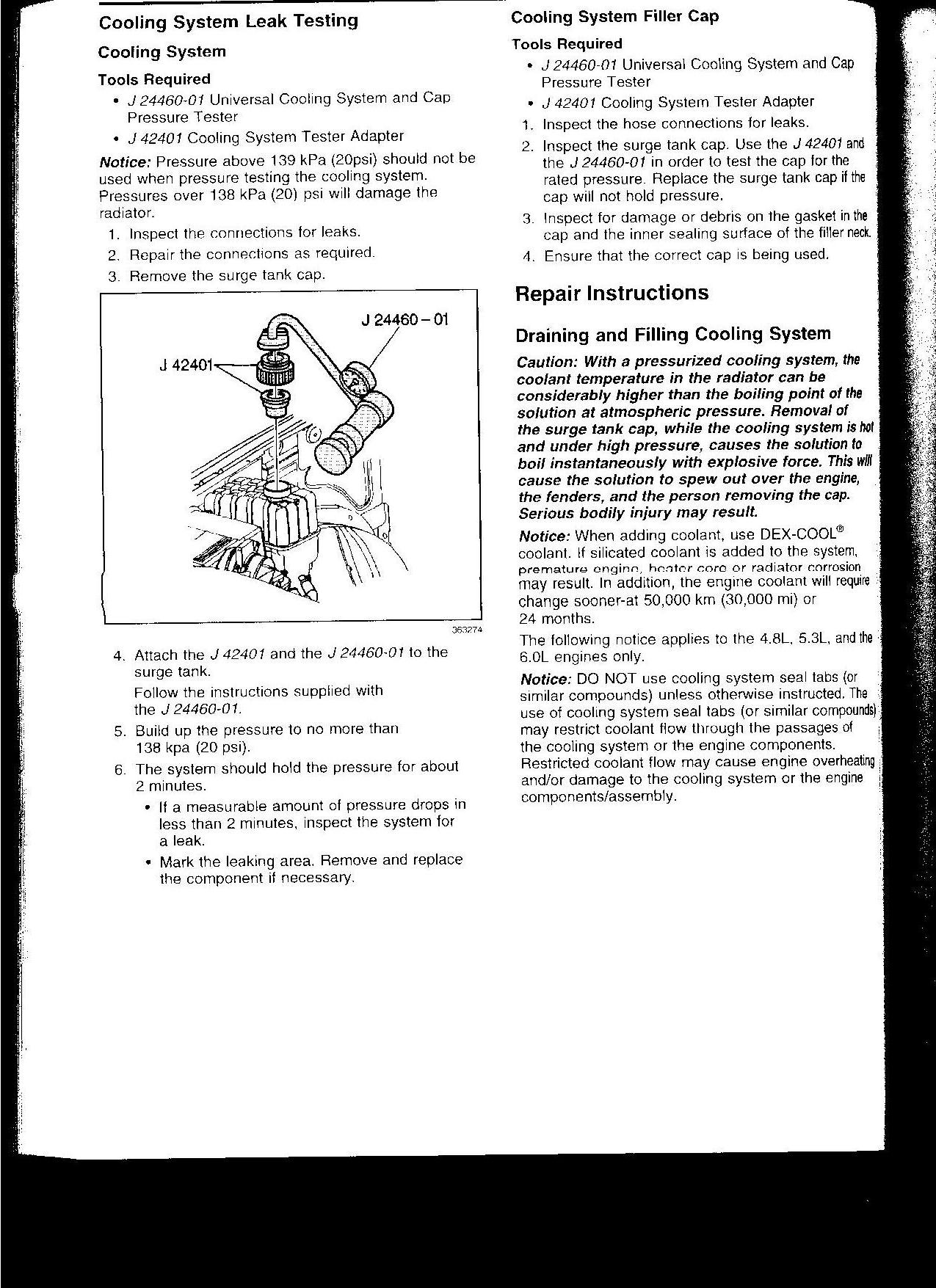

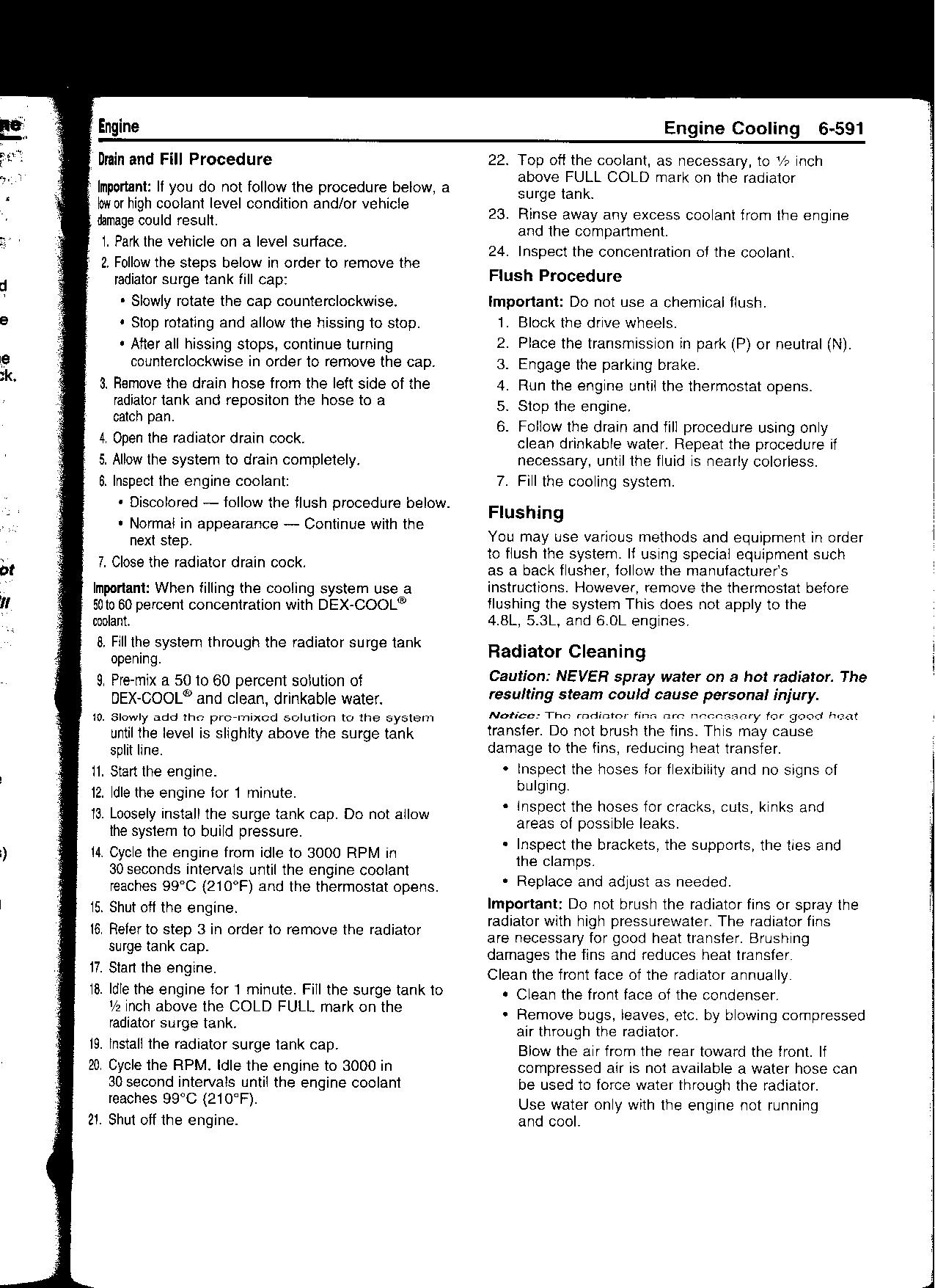

email me at [email protected] I have the scanned pages from my gmt-800 repair manual on how to do the flush. Its a word file
