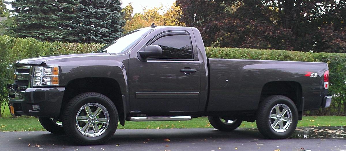

I have a DBS kit on my 2011 Regular Cab 4x4 for about a year now. Had it installed at a local spring shop $350 with a $65 alligment.
Although it has accomplished the ride height I wanted, i started going the other way when I put weight in the back. So ended up doing a add a leaf.. now the truck looks great.
What happens on a speed bump, going at a low speed it feels like the truck launches off and drops. if you hit a pothole at road speeds (35 mph) you get a large "BUMP" teeth knocking.
I knew going into to the kit I would experience some stiffness
I researched the Blistien 5100 adjustable shock/strut. Going to change out to these, I just think my shocks are extended out too much.
if 2inches is all you want on your truck buy the RC 2inch kit. its so easy to put on plus it saves you a lot of money. i had one on for a year before i switched to the bil 5100's and i didnt have any issues with my RC
Got the truck back after removing the BDS kit, still have the same ride hight of 39" measuring from the ground in the same spot in my driveway. Installed all four Blistien 5100 shocks with the fronts on the high postition.
The ride is great, the truck does not slam into holes, alot better going over bumps, the shocks do not bottom out.
Had two trucks with spacer kits, and now I will be going this route as long as the Blistiens hold up, which I am sure they will.

    • Is it an optical illusion in the pic or is the truck really squatting that much horribly?
