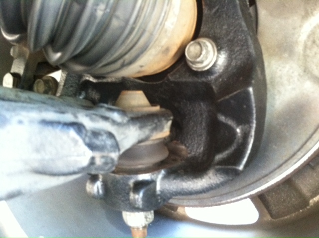

So looking at it from the front, here's the zoomed out right side showing the lower control arm where it connects to the steering knuckle. Then a close up of the right and the left side showing where the metal has worn down. Last image just shows it prior to wheel lock where the lower control arm steering stop meets the steering knuckle.
look alright to me?
that looks correct. That is the bump stop and the spindle is ment to hit the LCA. I think your alignment is off. I just lifted my front a little more on my tahoe and I get a noise when I turn sharp also . I just need an alignment and it will be gone.
Another thing would be check and see if you are running on you frame or swaybar at full lock. I had this happen on an s10 I had when I put bigger tires on. The tire would rub on the swaybar and rubbing noise and it did feel like it was grinding in the steering wheel.
I know it looks alright in the pics, the issue is that it will turn another two inches past where the photo shows compressing the suspension and grinding while moving. If the alignment can fix this, that'd be awesome! I just couldn't hold the wheel at lock and snap the pic at the same time...
In your first picture it looks like there is rubbing on the frame. Also I noticed how you ABS sensor wire is stretched out to the max but I don't know if that will affect anything.
