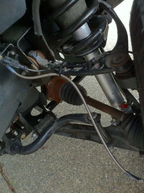

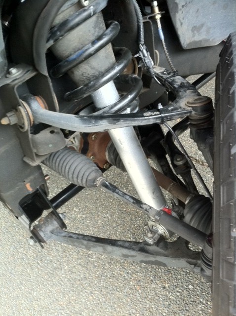

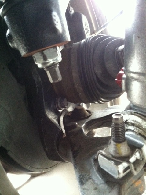

First off, thanks for all the replies! I'm still waiting on a response from Rancho too.... Hopefully these photos will help answer some questions and I'm more than happy to take more if someone has some suggestions. Would an alignment affect where the steering stops hit, assuming it's hitting equal on each side now?
With the wheel at full lock to left:
Photo 1- looking at the driver side from the front.
Photo 2- Looking at the passenger side from the back.
Photo 3- Looking at the passenger from the front, you can see where the lower control arm hits the steering knuckle. I understand that this acts as the steering stop, but I think it's because it's hitting this too soon by at least a full inch that causing the suspension to compress on one side and make a grinding noise while making a hard left or right turn.
Also I noticed how you ABS sensor wire is stretched out to the max but I don't know if that will affect anything.
Yeah, I THINK I got it routed okay on one side, but wanted to put a couple miles on it to make sure before I adjust the other. I assume being snug is okay against the knuckle so long as there's some free play up top to move...? My big concern is that it's going to rub on the wheel and take out the wire.
Everything looks fine from those pics. What size tires/wheels? Are you certain that the tires aren't grabbing the fender liner?
Oh no, stock 18" rims and stock 31.5" tires. Got plenty of space to add 33" or 35" tires later once I finish saving up so nothing rubbing now. Only thing I see making contact is the lower control arm. I know it's suppose to in order to prevent over steer, but it seems like being able to turn the wheel an inch or two after it makes contact isn't right, especially since it compresses the shocks down on one side while turning at wheel lock. Noise aside, is that going to harm/damage anything in the long run or crest too much of an impact if I turn to wheel lock too fast?
