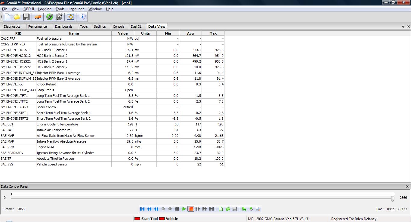

brienkd Posted August 15, 2011 Author Posted August 15, 2011 ABE area? Where exactly? Moore Twp exactly. I just bought a Palmer performance scan tool and trying to figure it out. As far as I can tell it the ecu doesn't support fuel rail pressure monitoring. So no I haven't. I have to play with the scanner some more and try to figure it out. The scanner shows no codes and the cel is not lit. There is a comment that the voltage is high for the fuel level sensor. I did notice that the voltage on the O2 sensors on bank 2 are a little high and my stft is a little lean which doesn't make any sense given my lousy gas mileage. I can run a scan and post the log. Just tell me what to monitor.
Krambo Posted August 17, 2011 Posted August 17, 2011 ABE area? Where exactly? Moore Twp exactly. I just bought a Palmer performance scan tool and trying to figure it out. As far as I can tell it the ecu doesn't support fuel rail pressure monitoring. So no I haven't. I have to play with the scanner some more and try to figure it out. The scanner shows no codes and the cel is not lit. There is a comment that the voltage is high for the fuel level sensor. I did notice that the voltage on the O2 sensors on bank 2 are a little high and my stft is a little lean which doesn't make any sense given my lousy gas mileage. I can run a scan and post the log. Just tell me what to monitor. The PCM will not monitor fuel pressure and therefore not a scannable parameter. Elaborate on the o2 sensor voltage...are they oscillating or are they flat, vehicle warm or cold during this time? STFT's will bounce around...monitor LTFT for the time being, post up the values. Don't worry about the fuel level sensor. What are the timing values when driving? BTW, I live outside Bangor PA in Washington Township.

brienkd Posted August 22, 2011 Author Posted August 22, 2011 So this morning I went to start my van, I had not ran it since Friday night, I turn the key it sputters to life goes kachunk, kachunk, kachunk and stalls. The smell of gas is overpowering. It took several minutes to get started again and I had to hold my foot on the pedal while it sputtered and misfired. I had to keep it revved up for a good minute and a half before it would even out and stay running. I have heard that the fuel rails leak inside the manifold and could cause this condition. Is there any truth to this and how do I check? This is a screen shot of a 30 minute drive. I can upload the log file if you would like to see it and have the program. You can download an evaluation copy that will let you view the log file here: http://www.palmerperformance.com/downloads.php
brienkd Posted August 22, 2011 Author Posted August 22, 2011 screen shot I'm watching the data stream and my VSS is way off like 20+ mph the voltage to my O2 sensors drops to 0 several times for several seconds.
streetperf Posted August 23, 2011 Posted August 23, 2011 , according to the screen shot, the engine isn't running. You have the last data when you turned the key on. Start the engine and get live data. Have you checked the Cat for plugging up? Install a fuel pressure gauge on the rail, near the distbributor, drivers side, and determine fuel pressure. Should be in the 52-55 PSI range KOEO or more. Running should be about the same. IF the fuel pressure starts dropping right after turning off the key. Pinch off both supply and return fuel lines, that will tell you either a leaking injector or regulator. Hope this helps. Mike
brienkd Posted August 24, 2011 Author Posted August 24, 2011 The screen shot is after a 30minute drive and shows the min, max and average. You can see the time in the lower right corner. That is correct that the vehicle is not running. I could upload the whole drive if you want to see it.
