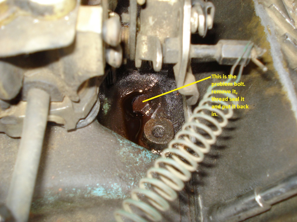

If you still have this problem, don't take it to a shop just yet! 15mins and a $5 bottle of thread sealant might save you a very expensive repair bill. I had the same problem, drivers side intake manifold in the little valley between the intake runners. Simple fix pull the bolt in the area of the oil puddle, put a little thread sealant on it, and put it back in. Should fix your problem. I've attached a picture of where mine was leaking.
I had the exact same problem with my 93 yukon.....pulled 2 of the bolts out...added sealer.....put them back in and no leaks since.
