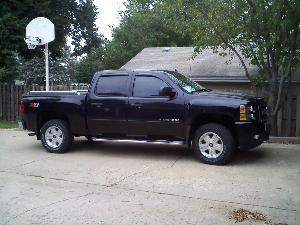

Hey Guys, I have a 2" level on the front of my '11 silverado 1500, im still about .5" to .75" lower in the front vs the back. The difference is very noticeable to me as it has been 2 months since installing. the pic is right after install.
I dont want to add more to the front for two reasons,1) another $60 alignment and 2) reduced suspension travel downward and more angle for CV's to adhere to.
so my question: does anybody know of rear blocks that are about .5" shorter than stock? is this a good idea? I made the front leveling kit myself, i've thought about making some new rear blocks as well..? I plan to install assist airbags someday..
Thanks for your input!
Luke
i believe the stock block is 1.25-1.5, go buy just a 1.0" block and see if that satisfies you
and im ignoring the fact that you "made the front leveling kit yourself" as that could open a whole can of worms on this site
I removed my rear block for the same reason. Even after installing the Rough Country 2" leveling kit the rear sat a full inch higher. (It was 3" higher in the rear when stock.) The rear block measures 1.20" tall. However, the rear dropped exactly 1" after removal of that stock block. If you find a 1/2" block please post it up.
Steve
