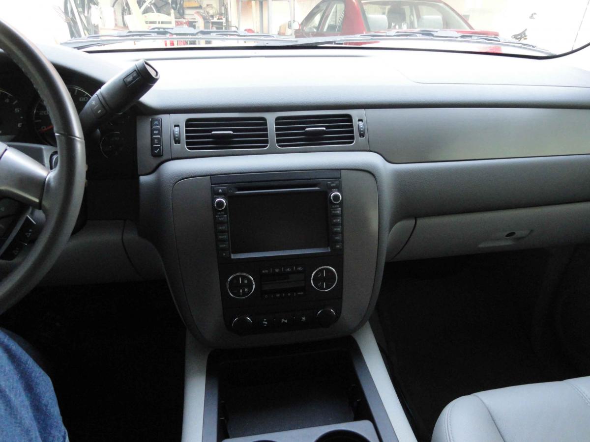

Thanks for the pics. Keep us updated with any snags or problems you might encounter. Also please post a before and after pic of installation!
I totally forgot to take any before pictures. But after installing this thing, who wants to remember life before it :D

Install went fantastic. The only thing left is to kink out the factory backup camera integration. (Not working but almost positive it's a user error) Installed in about an hour. If I had to install another one tomorrow, i could do it in less than half that time. Very impressed with the sound quality. Makes the stock speakers sound 100 times better. I have a very low ringing in the front speakers that can only be heard when the system is turned down all the way. Again I am sure it is user error. Probably have some RCA's touching behind the HU. I am going to get back in there tomorrow and fix it. I will also take some pictures, have not had the chance tonight. Been playing to much.

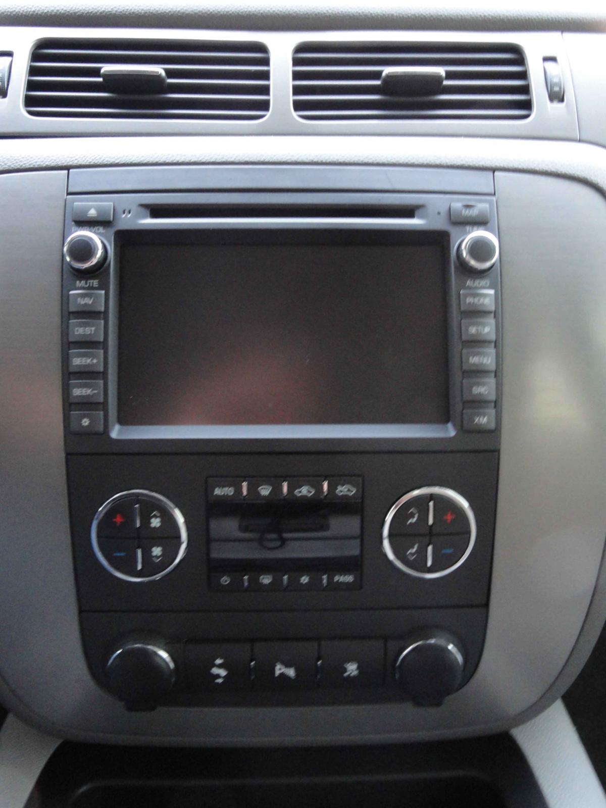

Here are a few picks of the install. So far.... Loving this thing!!! I am going to take some time in the next few days and write a review about the whole thing. There were some things in other reviews I wish were talked about so i am going to try and focus on the stuff not already said.
post-107034-0-08239300-1327194466_thumb.jpg post-107034-0-91100500-1327194471_thumb.jpg
That looks great!! Thanks for the update and the pictures. Looking forward to hearing your full review. Gonna be very impatient for Walt to return my call now. Darn mother nature. :)
