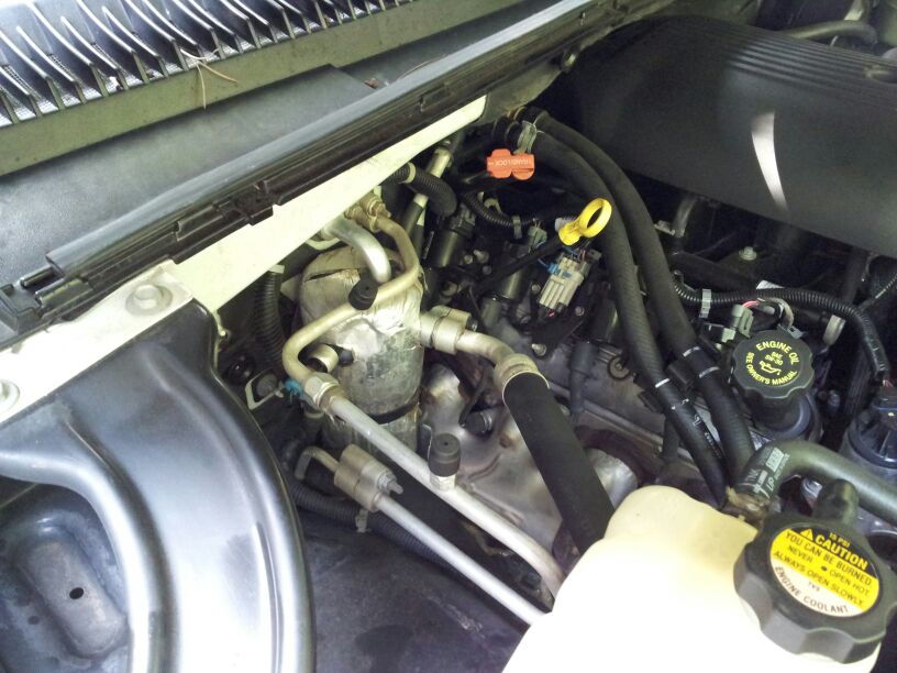

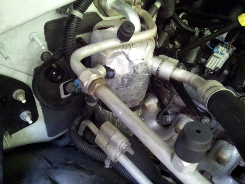

Where is the orifice tube and how did you get at it? Took a look at my truck last night and couldn't find it.
I'm not entirely sure, except it's "inline" type so it won't be a seperate house like your accumulator/dryer. If I were take a "guess" it in the tube between the two service ports but that could be entirely wrong.

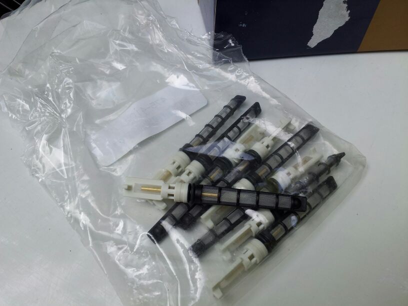

Here you go. In the following pics you'll see the two nuts on the line. Hold the one closest to you still and loosen the one in the rear. (that sentence just sounds wrong)
Once separated, you'll find the tube in the line closest to you. Use a pair of needle-nose to pull it out.
The last pic shows what it looks like.

Thanks for the info. Didn't realize that the orifice tube was in there. I got everything replaced and the truck is at the shop right now getting charged. Took about 4 hours for everything (you gotta work in some pretty tight spaces to get that compressor out).
