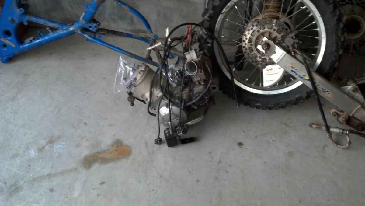

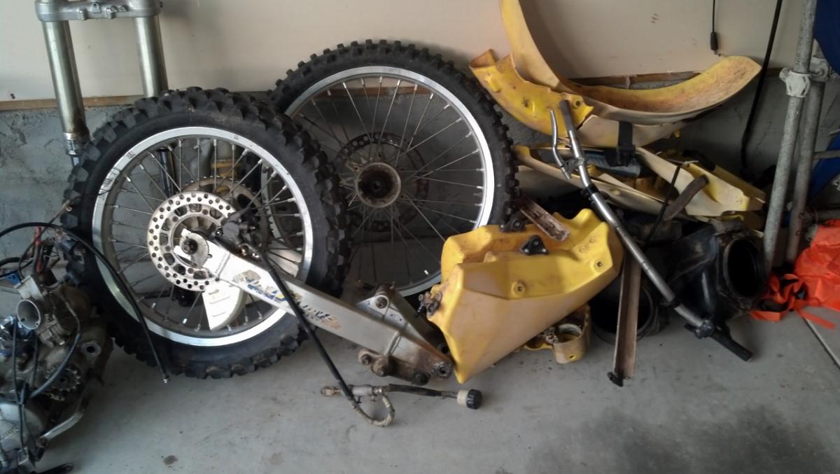

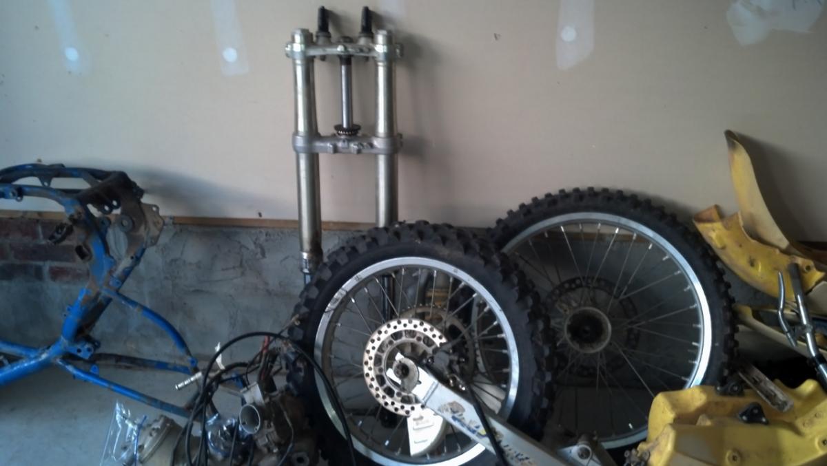

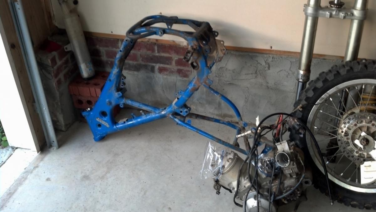

As promised, here are some pics, I only included the completed tear down with everything thrown into the corner lol, the actual tear down pics are reference's when I need them to build this monster back up lol.

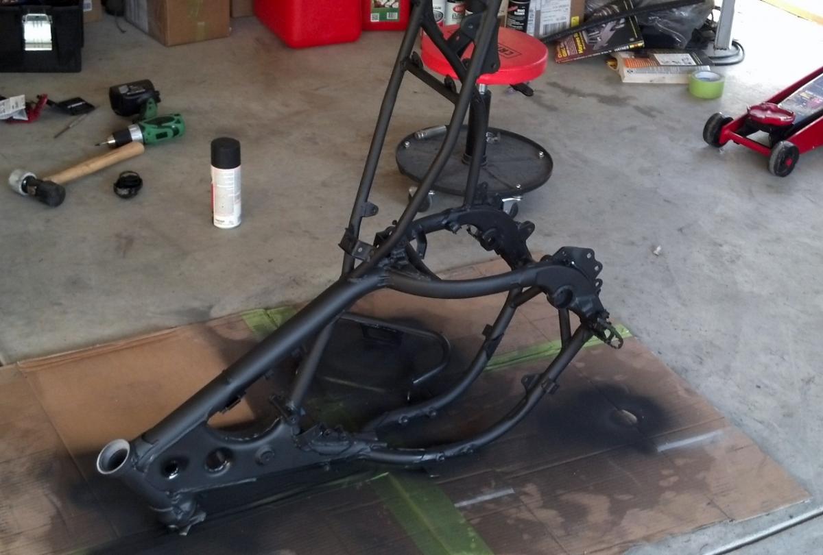

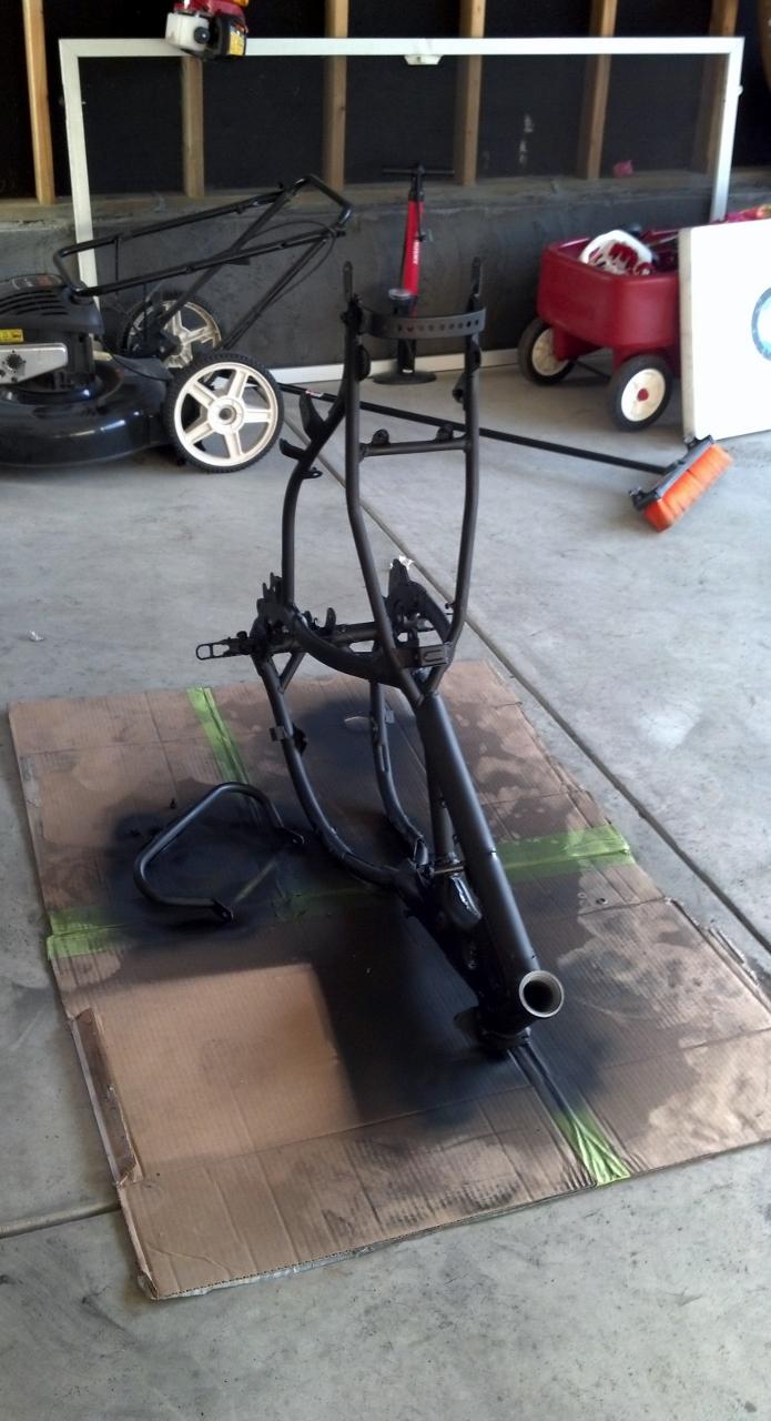

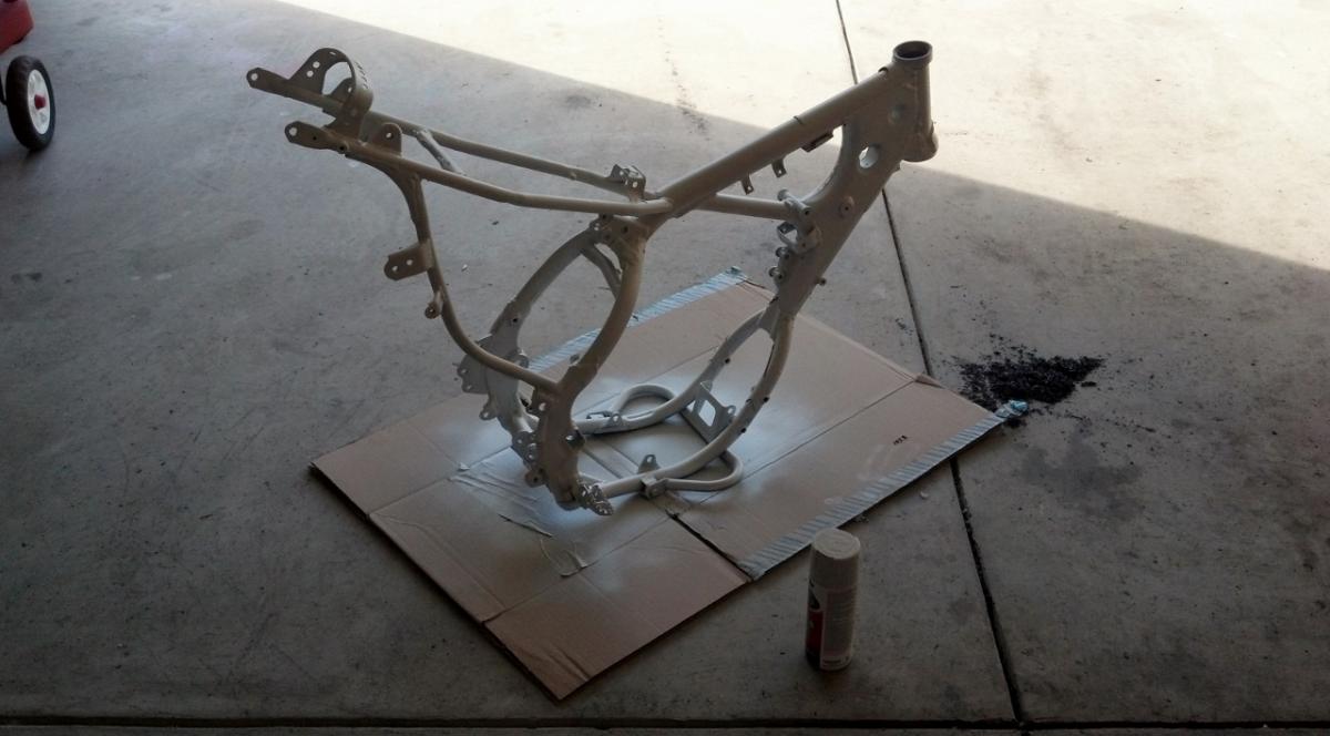

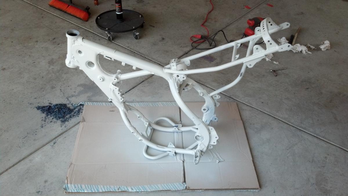

Also, put the first top coat of flat black on it, this thing looks bad ass with the flat black!

I am still stuck on what color I should paint the plastic, I was going to do an all black thing but I am thinking of just the frame and repainting the original plastics yellow. Any thoughts on this?

The frame still needs one more coat before I get the matte clear coat on it. I also have to sand down one of the joints to get a weld repaired this weekend.
