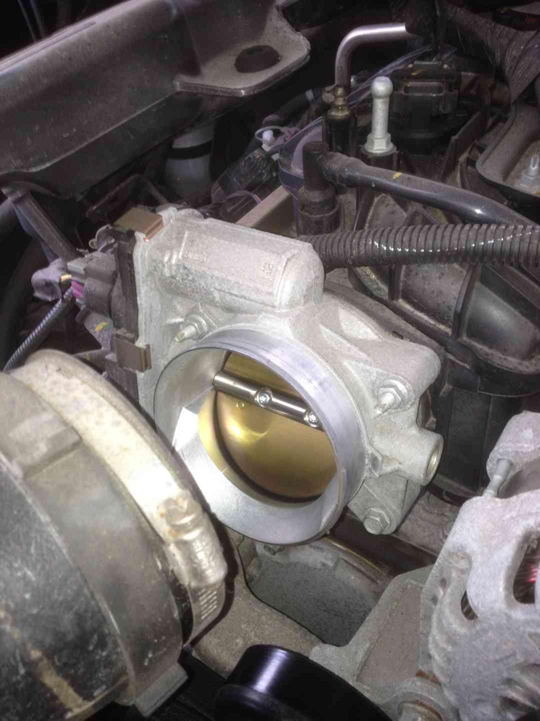

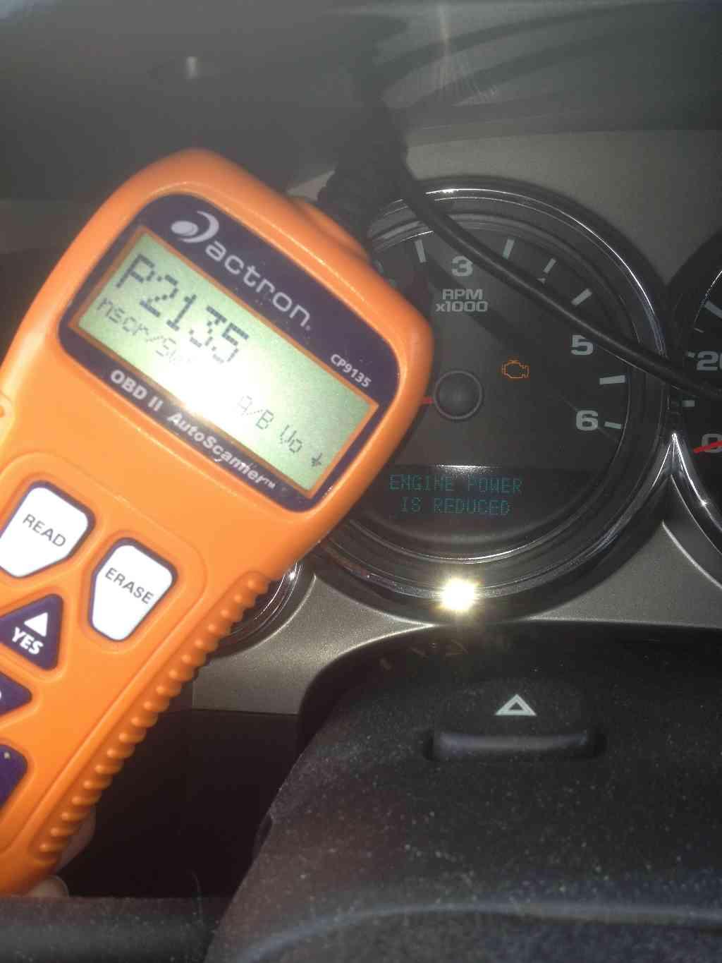

Back in January the "engine power is reduced was coming on regularly. Called the closest dealer who said I had to bring it in with the codes for the TPS warrenty. Well I could not be without a vehicle for a day and driving it in that mode would take forever. Or I could pay for a tow. So I decided to just replace the throttle body myself. Here are the codes, the P2135 all the time and the P0121 sometimes.
Here is the original throttle body
The red arrow points to the light grey locking tab that needs to be removed before the main plug can be removed.
New throttle body. About $135 delivered.
Installed in less than 10 minutes. You can see 3 of the 4 nuts/bolts.

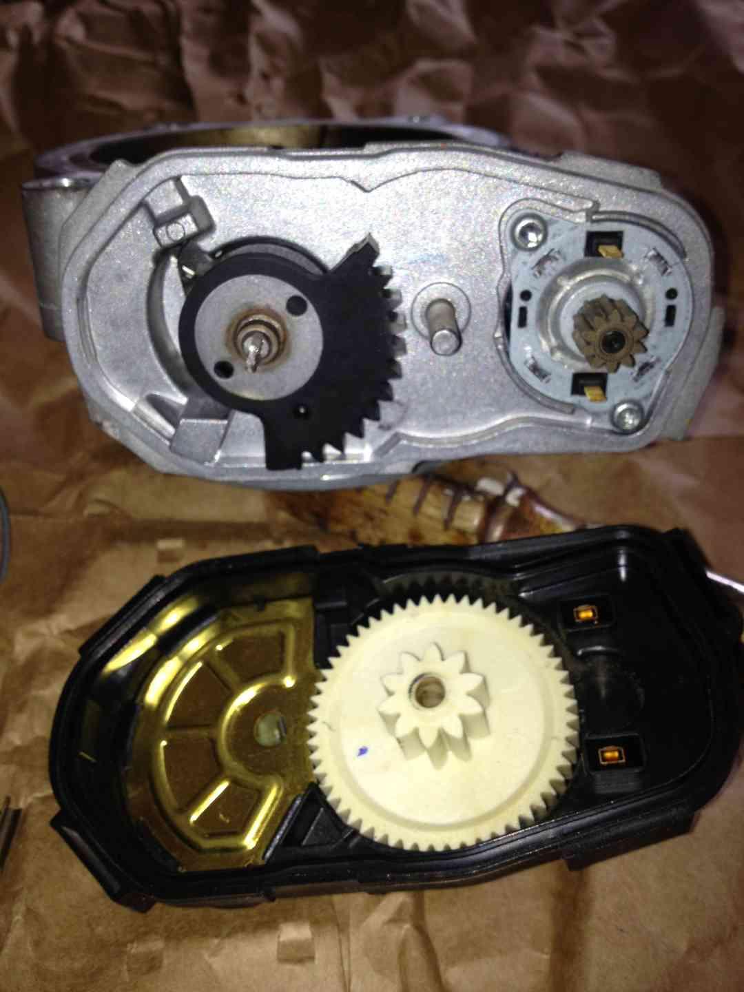

Curious about the innards of one of these throttle bodies I decided to open up the old one.
Looks like all I have to do is pop off those clips.
Now much in there. I did expect more with the multip prong input. Tried to take out
the motor, sheared off one screw head, Other came out with some difficulty. Pried a bit
on the housing but no budge. Tossed in trash.

I had the "Service Traction Control", "Service Stability Control", "Engine Power Is Reduced" messaged also the same two codes on my 2011: P2135 an P0121. my TPS sensor failed on me at a little over 52,000 miles. I was on my way to a horse fair in Springfield, IL this past March 2013, about 100 miles from my destination. I pulled into a hotel after 15 mins restarted and it was fine, drove another 80 miles an it failed again. limped the rest of the 20 miles on the side streets to my hotel and limped it to Friendly Chevy, in Springfield, IL in the morning. They found the TPS bad, replaced it, my total cost was $257 to fix. I can't complain cause this is the first issue I had with this truck as is was flawless up to this point. I now have over 57,300 miles and never had an issue again. Friendly Chevrolet in Springfield, IL was an awesome Dealer and I thank them for their GREAT service!
My TPS sensor looks exactly like what Mr_Rooney's pictures, I know GM uses this same sensor on a whole bunch of engines. I have the 4.3L V6 in my 2011.
