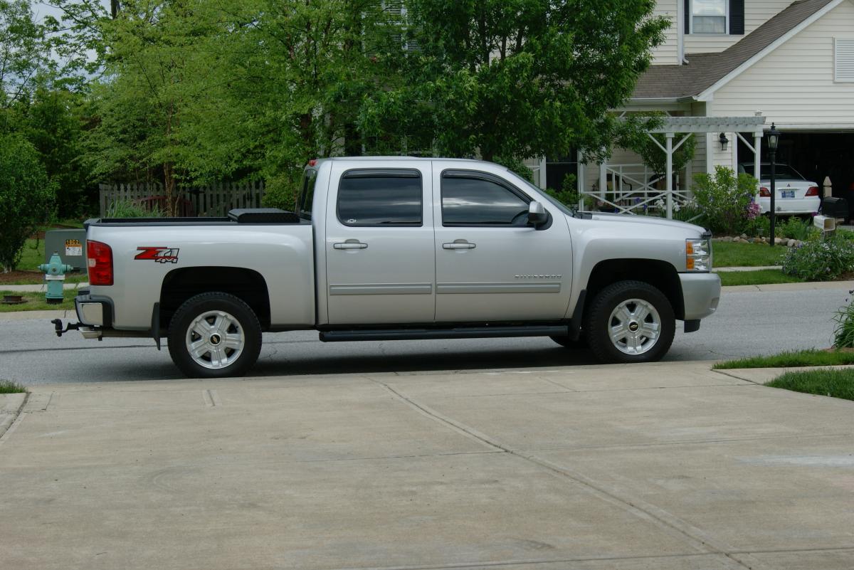

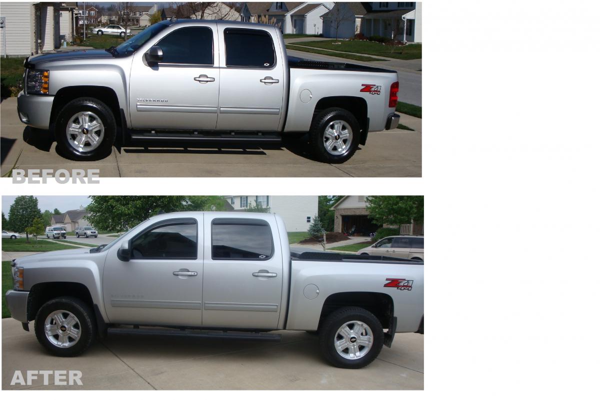

Do these pictures have the 3" block too?
RC 2"
I also added 3" rear blocks
Yes those pics are with level kit and rear blocks
Ryan
I did a similar setup as mentioned above on my last truck, and was very pleased. On this one, I did 2" front level kit and 2" rear block in place of the factory 1.25" block. IMO, that setup looks good too.

It depends on how much rake you want to have. A 3" block in place of the factory 1.25" block will give you close to a factory stance, the whole truck will just sit taller. A 2" block in place of the factory block will keep the truck closer to being level, without the front being too high, when towing or hauling. How do you want it to look?
You can check out my gallery if you want....my old truck had the equilivant of a 3" block, while my current truck has a 2". Both had a 2" spacer up front.

and to the OP, i would get whatever ryan has on his truck, perfect GMT900 stance
