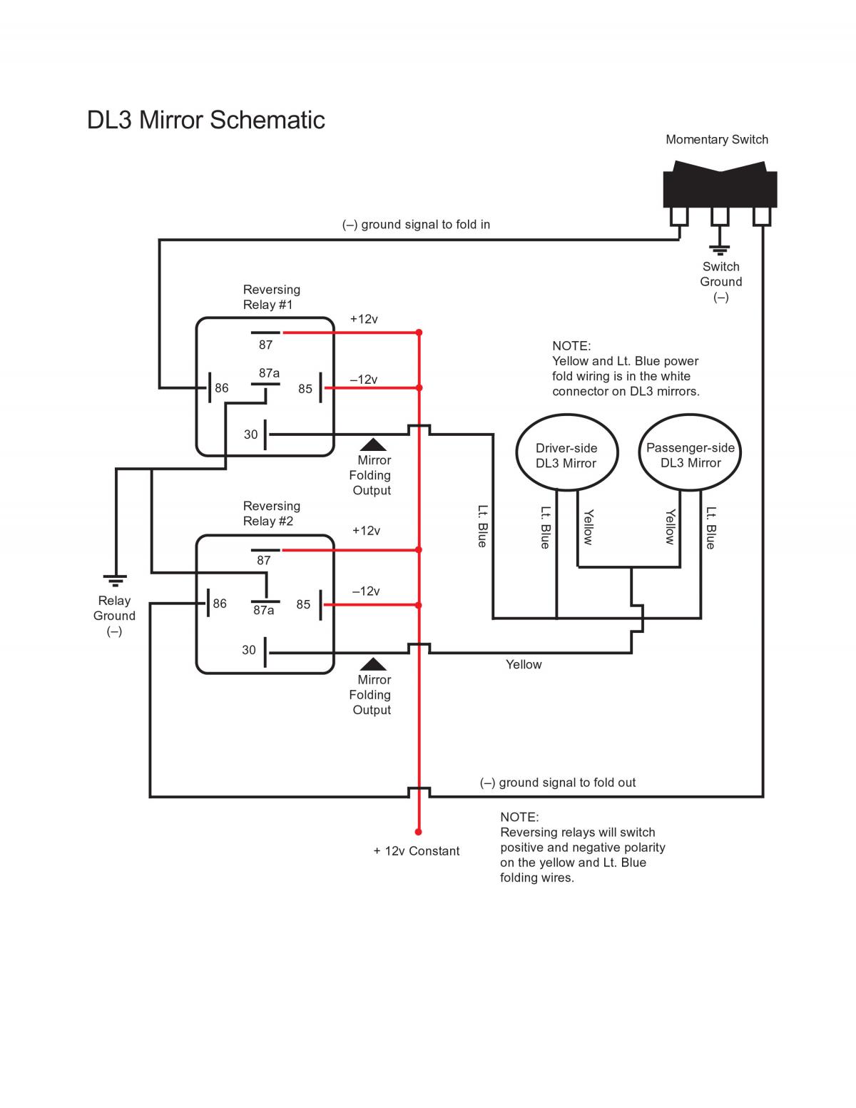

I did this a while back and I know there's a thread on here somewhere. I have posted the schematic that works without having to purchase the factory switch or wire harnesses (or pay a dealer to activate). You need a momentary rocker switch (I mounted it under the headlight switch to the left of the steering column) and a couple of relays and some wire.
thanks spryguy i looked at my switch and i have the hardwired system i do not know if i could locate a harness for the doors or wheter it would be worth the trouble trying to get it all working i have read a lot of post and they say that if i just want turn signals just plug them in i hate to waste good money on new mirrors just to use part of them well back to more reading thanks
