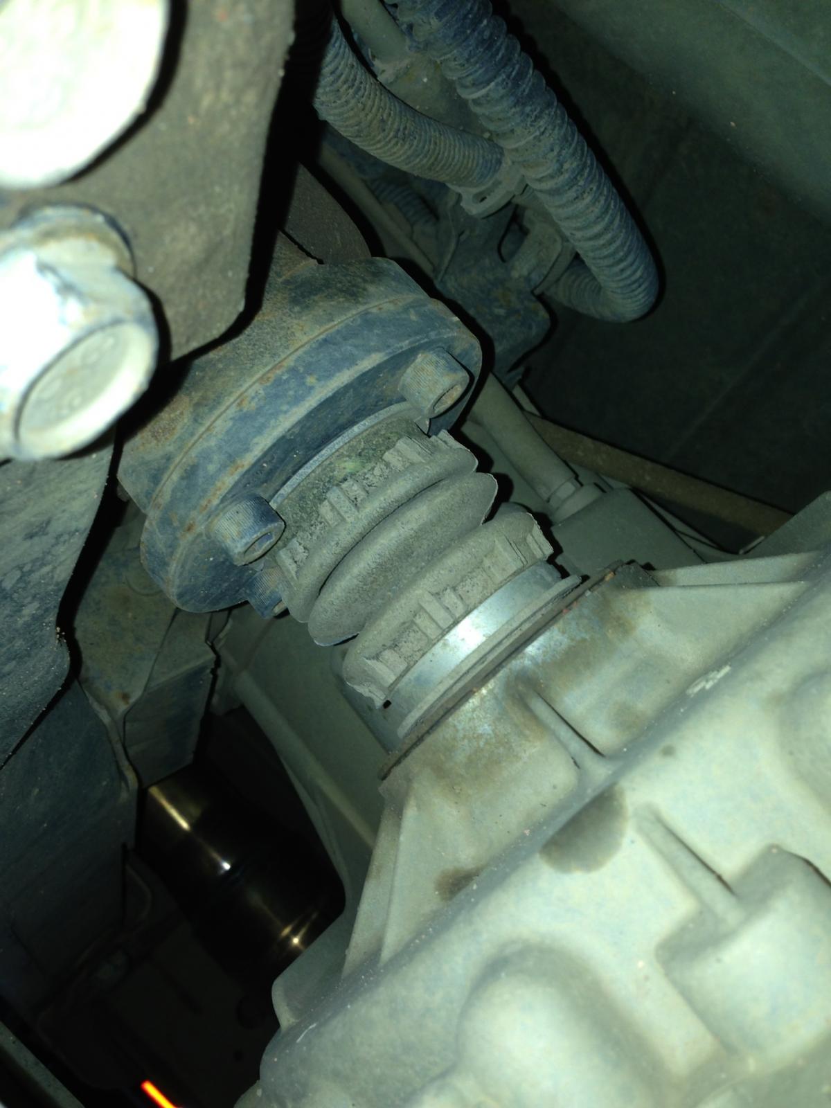

I know my driveshaft is too long. I had trouble with the Tom Woods measuring instructions and did the working length wrong. I didn't think it was too big of a deal because it still fit, but could this be causing transmission problems? Or robbing me of power?
neither powertrain part is able to move up and down so what is wrong exactly ?
if you remove the front u joint caps and pull the shaft off the diff yoke ,does it go into t case slightly ?
if you answered yes to the question you have no problem ,,,,im sorry you bought a lift kit ,,,,,i feel for ya brother !!! lol
Hahahaha yeah I love having it lifted but there's so many little things that change. As far as the driveshaft goes, with the old drive shaft the boot or cover used to be fully extended and now it pushes the boot all the way to the t case.
