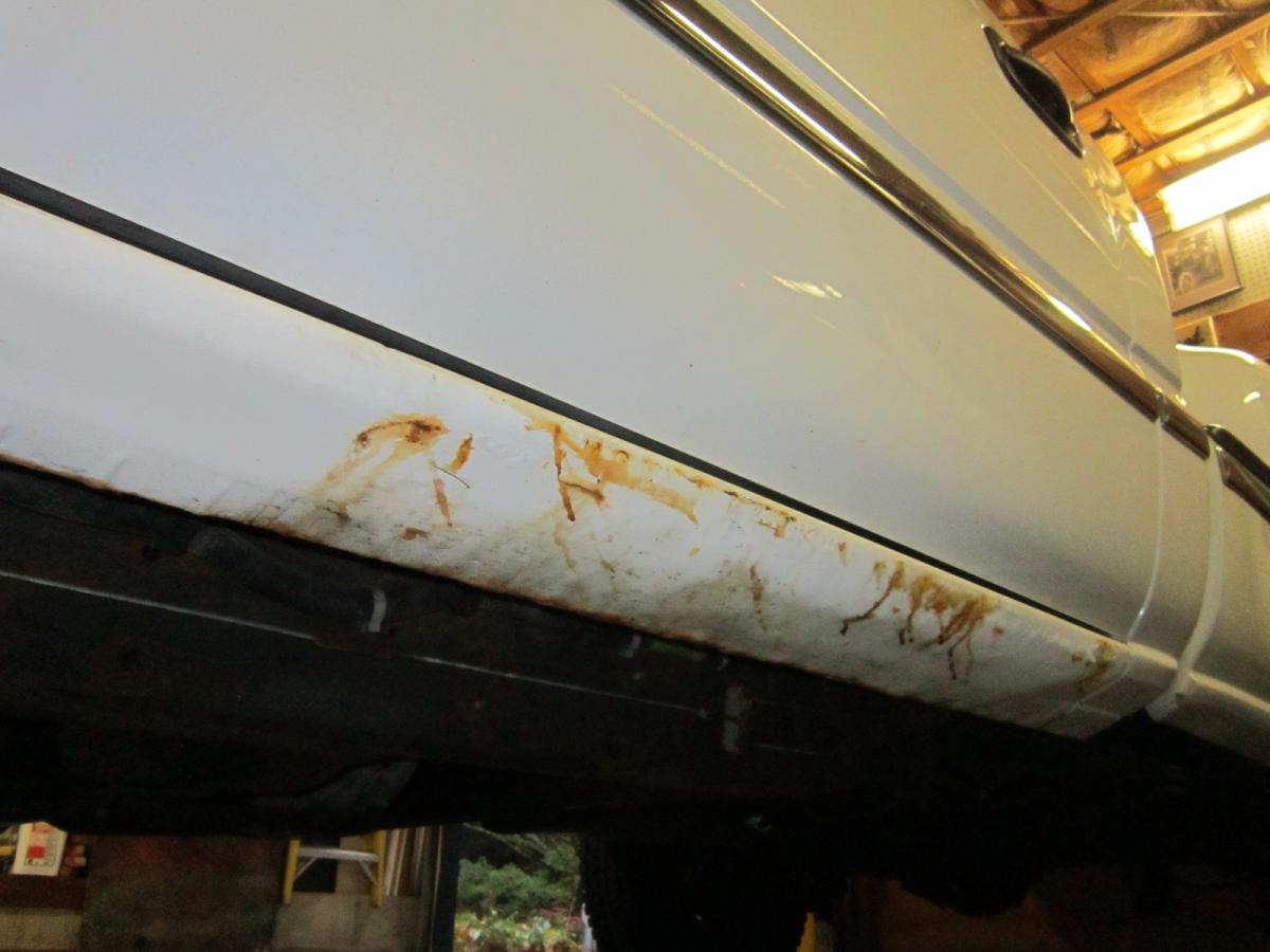

I just bought a 2002 Sierra step side pickup. It's in fantastic condition everywhere in and out but the left & right rocker panels. The cab corners are perfect as is the rocker section behind the lower fender on both sides. The door sills are also in fantastic shape! First off WHY does this happen? Second I'd like to fix the cancer that's there. I've been looking at different suppliers and have at this point no clue with whom the buy from. I see they have "slip on" repair panels which looks like what I would want. I'm sure I'm not the only one out there that has this problem . I'd love to hear some info back on the issue and possibly some photos of the repair with some pointers using the slip on repair.

Actually we have found that trucks with nerf bars are worse. At the rear where the tube turns in, it kicks rocks straight up. Every single GMT800 in Michigan has this problem it seams. They rot from the inside out. It is really terrible. I have a buddy that has a body shop and he fixes 1-3 Chevy rocker problems every week to the tune of $2500 each. He has a waiting list a mile long.

That doesn't look like chips to me. That looks like it's rusting from the inside.
Yup, if you get under there you will see why. The GMT900 will have the same problem. It is only a matter of time. The rockers hold moisture in the folds of metal. They are open on the ends and if you have any plastic plugs missing.

Umm, like he said a bunch of times lol. These have little to do with stone chips. It is solely due to salt/moisture finding its way into the crevices. My truck is normally kept extremely clean and I always shot used motor oil up inside those holes. It helped but mostly didn't matter because now they are starting to show rot. Heck, most of the Gm trucks around here don't have rockers anymore. I guess I should feel lucky lol
