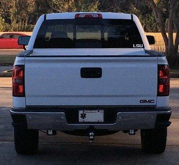

yup, i have them wired it as DRL.. They're only on when the key is on position and dim when they parking light is on to reduce the brightness

this is my reverse led bars " 2 of them"
This is the front 7" led bars
They are much brighter in person.. :D

Ordered a pair of Rigid Dually LED's tonight (#20111 / Flood pattern / 1568 lumens each).... will let y'all know how they look/function/perform this weekend.
Got my Dually's in tonight, tested them out, everything worked fine..... and then I noticed the Rigid SRQ's! GRIPE! Same four LEDs, same output, but in a more low profile package. :banghead:
Test fit and then installed my Dually LED lights.
I originally thought they'd hang down too far but you can barely see them from the side.
Didn't wire them up yet b/c the place online I where I ordered my specality rocker switches sent me the wrong ones.
Mine dont hang low either.. Did you wire them same way i did

Did you wire them same way i did?
No, I wanted to control them via dash switch so lights are on their own relay & wiring harness.
I have a question, doesn't the trailer wiring offer a reverse source to power the lights. I know most boat trailers anymore will not roll backwards without this wire or has that changed since my trailer was built?
Yes, if you use LEDs, it's completely feasible to wire them only to trailer wiring because the amp draw is so small.
