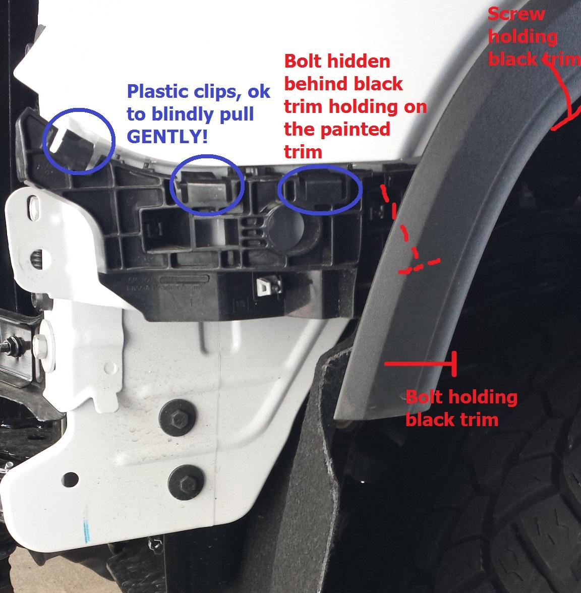

Im having issues getting my grill out
What's the issue?
found the tabs on the top to remove the cover.. Than there is 4 bolts on top.. 2 clips in middle... Each side..
Now there is 4 on bottom.. (10mm each)
Can't get to... Read some where that says you have to Pull the painted peice off above bumper....
found the tabs on the top to remove the cover.. Than there is 4 bolts on top.. 2 clips in middle... Each side.. Now there is 4 on bottom.. (10mm each) Can't get to... Read some where that says you have to Pull the painted peice off above bumper....
Yep. Start by removing bolts that hold painted trim in wheel wells (Silverado probably a little easier since you don't have black plastic fender flares).
Start pulling from corners to release snaps. Once you've got them loose to about the headlights, STOP! Slide under the truck head first where the front license plate would be. Behind the bumper about a foot up you'll see large painted plastic tabs (the lighter your paint, the easier they'll be to spot). If I remember right, there are 5 of them. Starting from one side, release them from under the truck & give each a slight push. Once all are loose, you can easily finish removing the trim standing in front of grille.
*Note: in the very beginning, after you pull back the corners, wrap them in a rag/towel. They flex/bounce around a bit if you're doing this job solo & can snap back against the paint. I found this out the hard way the 2nd day I had my truck. Put a 1" scratch on the fender!
(attached pics are GMC, not Chevy)
Still rather difficult to remove a damn grill
