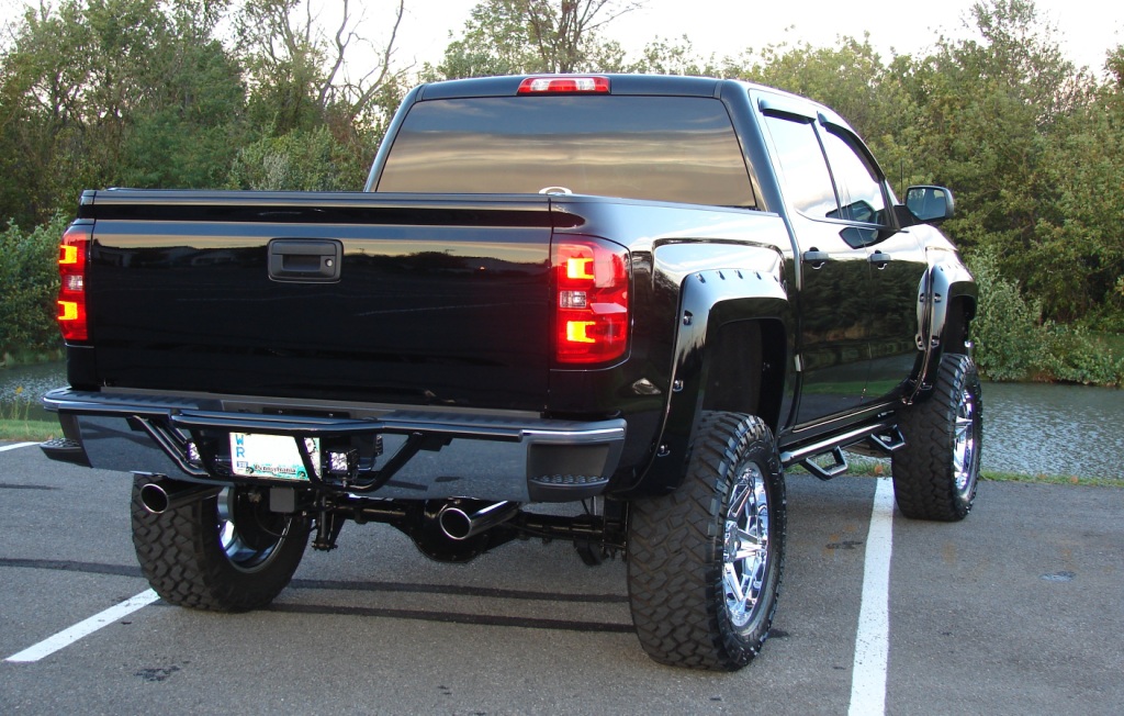

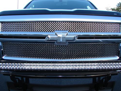

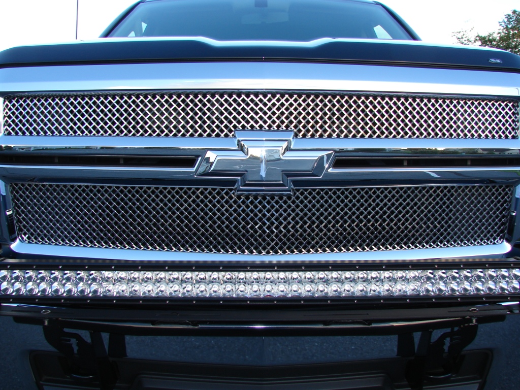

I have the original N-Fab light bar which you are correct mounts to the inside frame rails where the tow hooks are located. I can't imagine they would have redesigned the size of the bar just to add the multi mount rails, I assume they just welded their new rails where I have four tabs. Largest led bar I could fit was a 40" Rigid Industries which extends past the N-Fab bar slightly. I used the Rigid Industries 40" cradle mount and utilized the outside two mounting tabs on the N-Fab light bar, the center two were cut flush to the cradle mount since they will not be used. I really like my factory bumpers and planned from the beginning to find a way to mount the largest Rigid light on the front and a pair of Rigid Duallys on the rear, so N-Fab had the perfect solutions. I matched the front with the N-Fab Rear Runner.

One last picture. I tried to explain how I cut the center tabs on the N-Fab light bar and utilized a Rigid Industries cradle mount. This picture illustrates it better.
