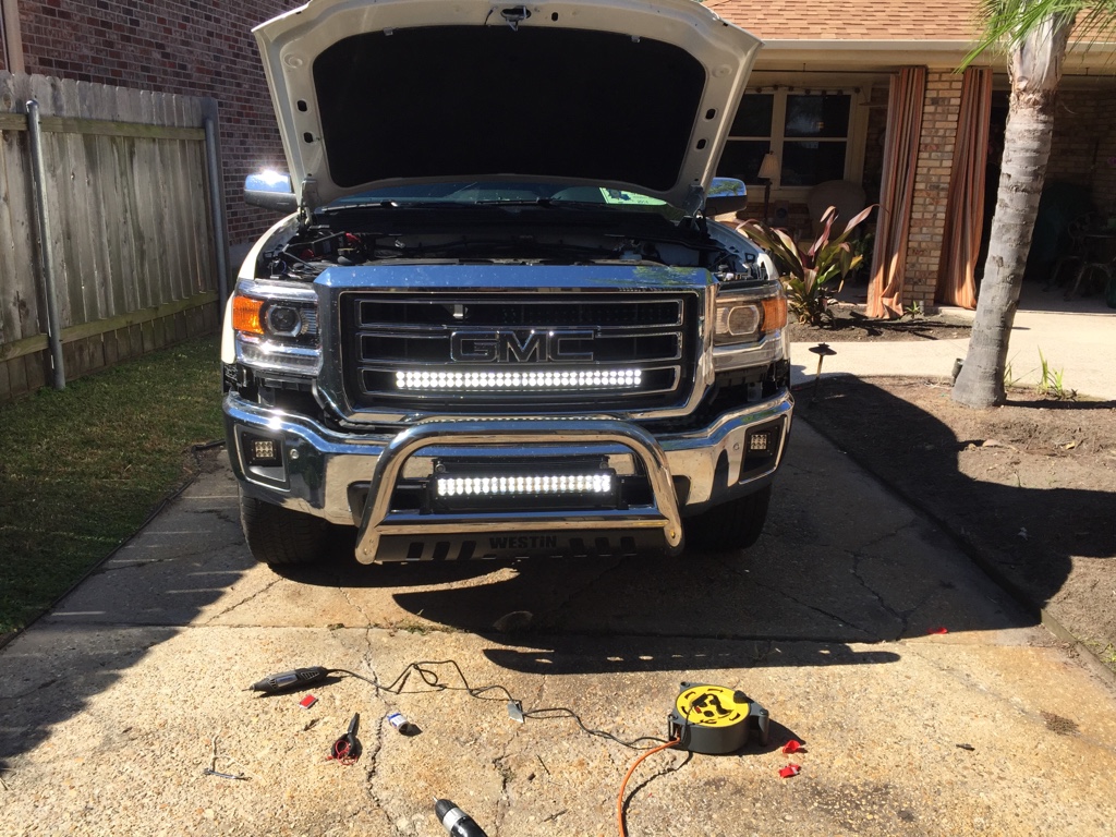

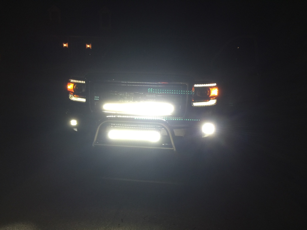

Just an update. I mounted another 32" bar behind my LTZ grill. I'm loving the light it puts out.
How much light does that grille block? from the pictures it looks like the grille is basically covering half the bar
Has anyone found a wire for the 10 minute retained acc power? All of the ones I have found only retain power until the door is opened. I want to be able to leave the light on after I open the door but not be on a always on so I can't forget to turn it off and drain the batt. Right now I have my relay for my light triggered by a wire off of the high beam but I'm installing some double throw switches in the console so the bar can be off, on with highs, or on with 10 minute RAP. I'm also going to do the same for my backup pods along with a jumper from reverse to the bed lights.
1 20" combo beam
1 30" spot beam only
2 rigid Dually D2 driving pattern for fog lights
This set up lights up a dark road. No more need for the high beams on low light roads

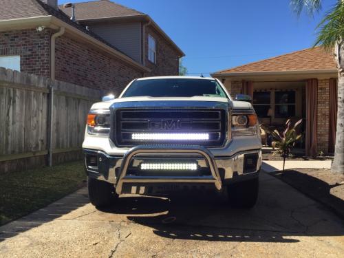

Here abunch of daytime pics!
The new 30" bar is a bit more cool white than the 20" but with how bright they are it's hard to tell when you look at them. They light up the road like crazy! And the 30" also matches the rigid pods!

Sorry guys for the late pics. You will notice against the garage regular low beam and then the new D2 Rigids. Also pics of the truck. Just love the lights and how they work! Outstanding to say the least.
1 20" combo beam
