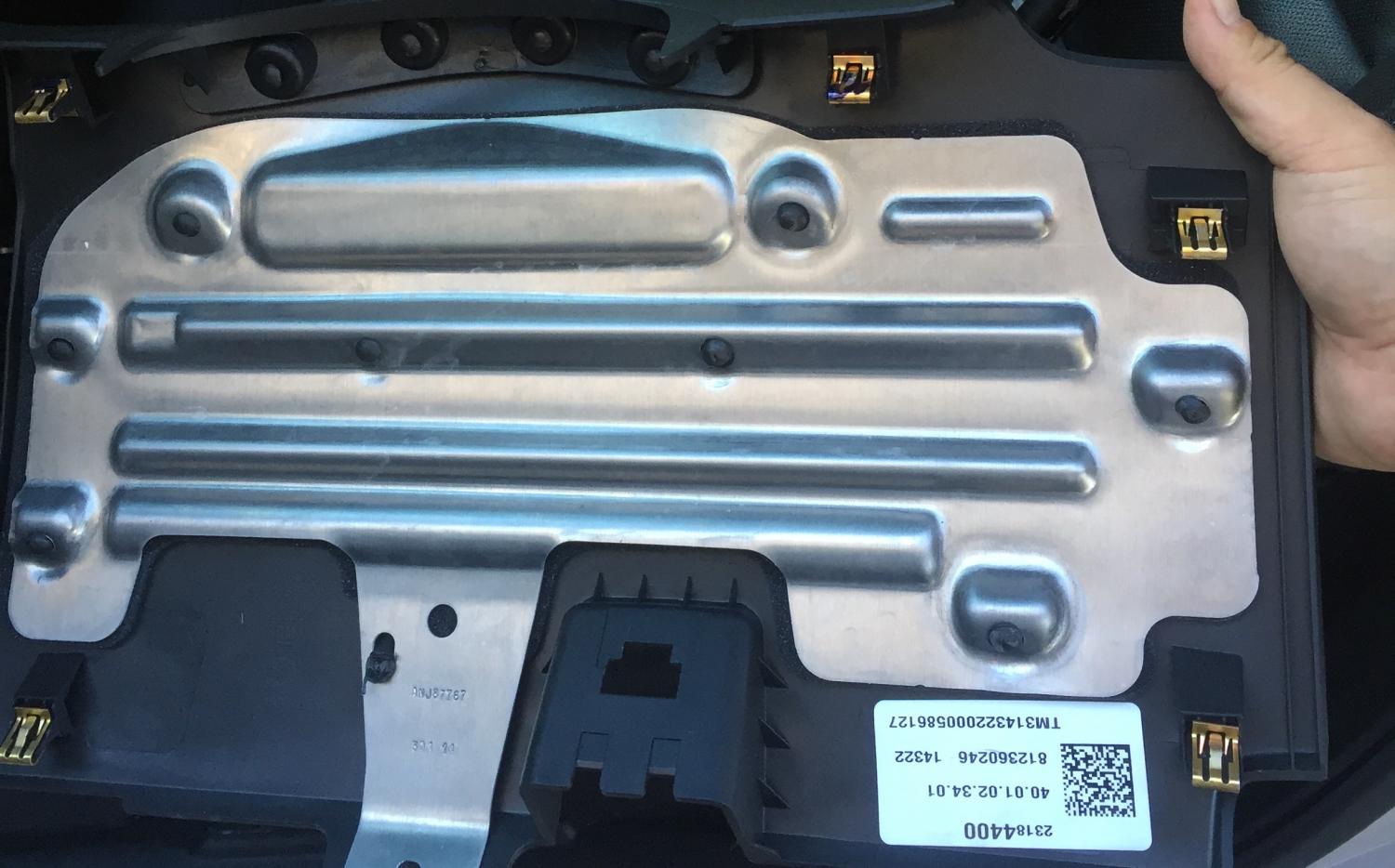

Well I was going try to put my switch to the left of the steering wheel when I came to a problem.
There a metal frame where I want to mount it. Then I seen another problem!!
So if I wanted to drill in the panel the only spot where I won't have interference is right below the steering column. I don't know if I want it there but I am running out of options. What do you guys think? Right below the steering column or some where else?
