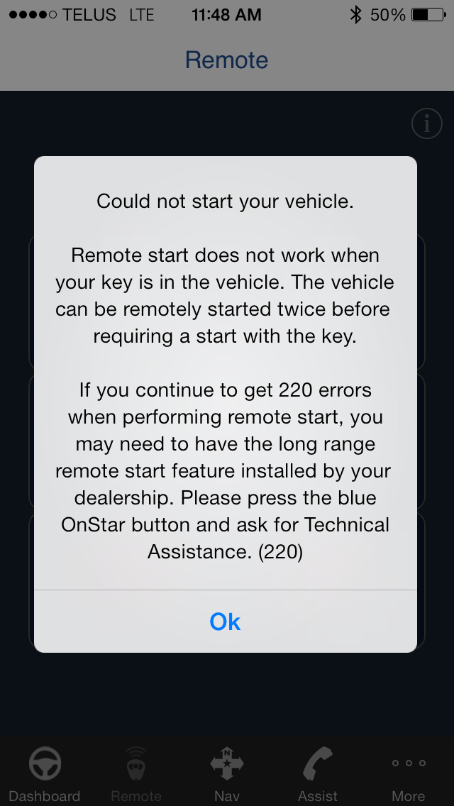

Heres a pic of the message i get. Guess its not a module but a feature i guess.
Press the onstar button and ask
Sent from my SCH-I535 using Tapatalk
So did you leave you keys in the ignition like the message indicates?

No my truck starts fine with the keys and/or my phone 2 times. Its just that it can't be command started 3 times in a row. I have to actually go to the truck and start it with the keys after the 2nd time. Call me lazy or whatever, it just seems really inconvenient.
Well, that's just the way it is. 2 times and 20 minutes. No way around it.
