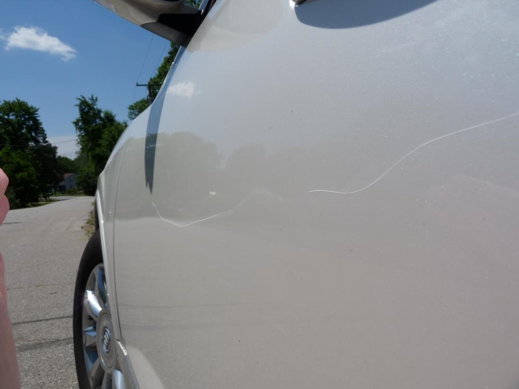

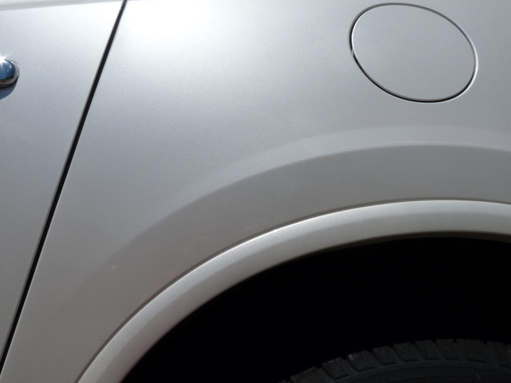

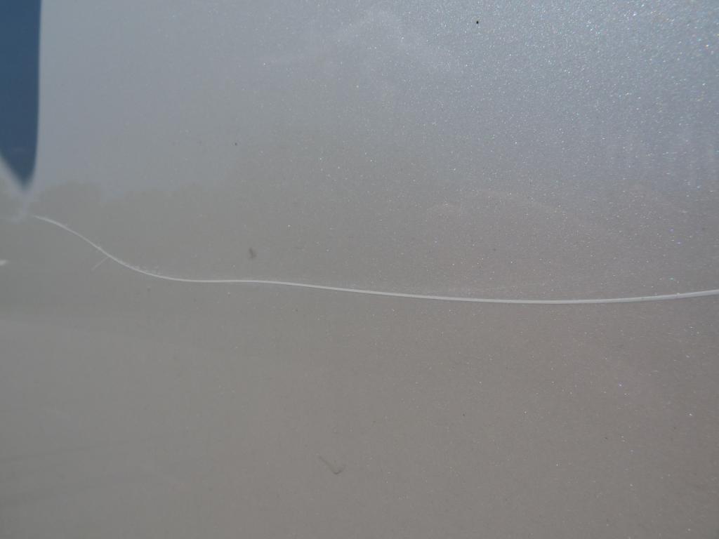

Let me see if I can post some pictures of my key'ed Enclave for you to see how it looked before hand.

Some areas of these scratches were deep.
post-89456-0-71820000-1389746506_thumb.jpgpost-89456-0-27188400-1389746517_thumb.jpgpost-89456-0-31122500-1389746527_thumb.jpg
