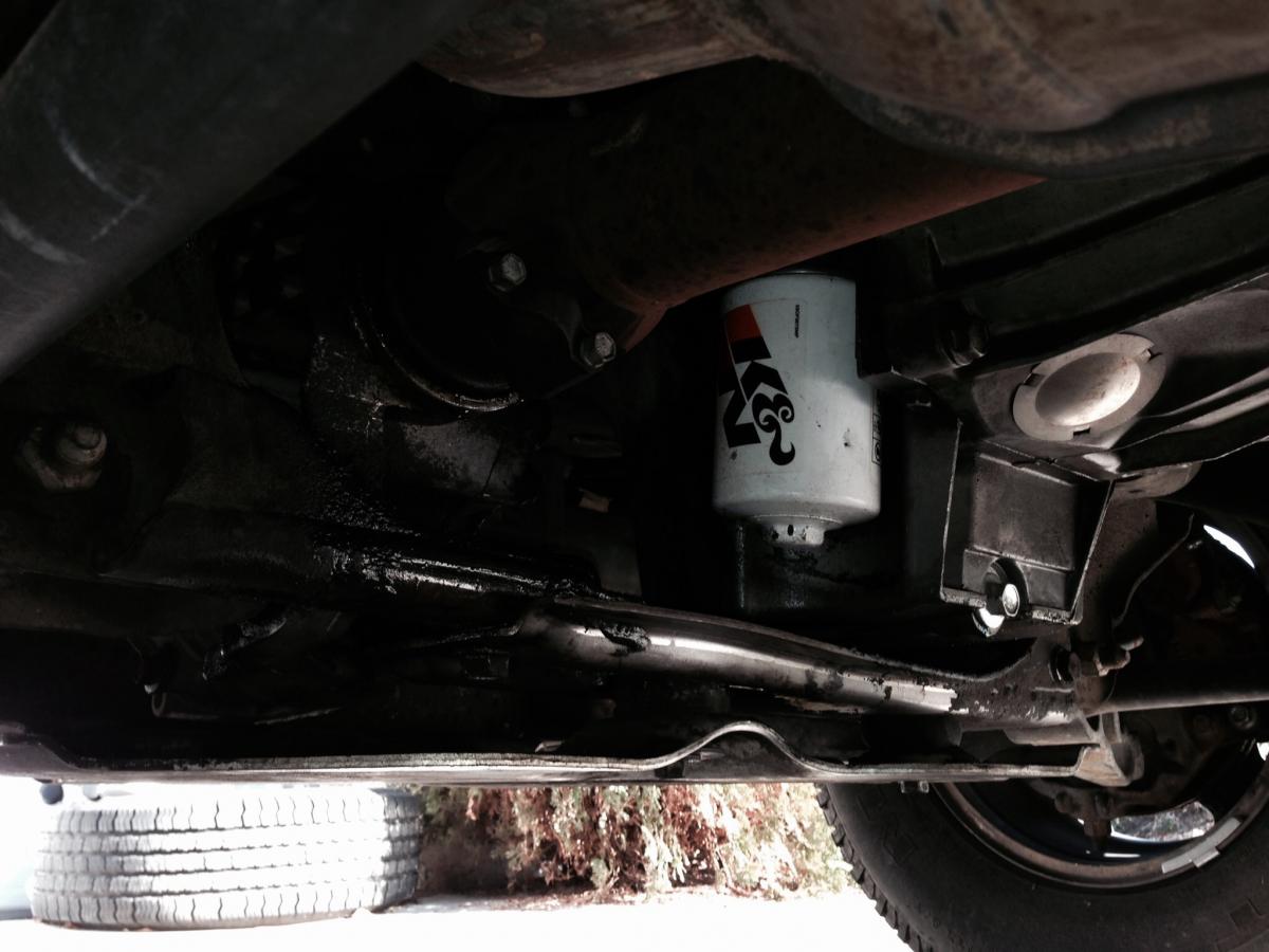

I have fluid leaking from the front of my truck, by the front differential. Any help is appreciated. Thankspost-74393-0-40425000-1394507075_thumb.jpg

Sorry guys, my mistake, I didn't mean to waste your time. I thought I posted this with a pic. If anyone can help, I sincerely appreciate it. If you need more pics I'll take more and post it in the morning.Thanks again.post-74393-0-35267600-1394506906_thumb.jpgpost-74393-0-36993500-1394506994_thumb.jpg
front diff pinion seal has failed ,,,,,(not gone bad) lol
possible bearings failure as well,,,,,,,big money if the later
the only way to check the rotation of that pinion is to remove the front differential assembly,,,split it and rotate it to feel the bearings
remove the front driveshaft yourself and push/pull the pinion and see if any up down movement ,,,if the oil is dark and shitty ,,,,you have a problem
welcome ,let us know what it is ,dont try to do this your self unless you have a clear understanding of how a pinion/crush sleeve/cheat ,(for the seal only)

You do not mention if you have any driveability issues! Have you checked the fluid level of engine, transmission, ps, brakes,...?
I would start by completely cleaning the area, then drain and refill the front differential. Note the amount of gear oil that drains out, if any. In my 2007 with only 40K mile, and no leaks, I drained the gear oil and it was about 1/2 quart short.
