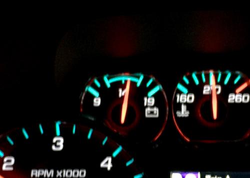

Voltage gauge normal reading

Hello, all. I believe I may have a more serious issue. I very rarely see my gauge in any position but either full charge or off. As a result, I believe it is causing the same issues people are seeing with regards to vibration and transmission shift point and firmness. As they're all electronically controlled, they are all related. I have nearly had my pickup die as I pulled out into a fairly heavy traffic situation, and sure enough, once I was out of danger of being t-boned by a gravel truck, my gauge was sitting almost level with the low "acceptable" needle. When it's on the low level, the truck idles rough, the transmission is sluggish and slippery, shifts too soon or too late, and vibrates more at highway speed than it does when I'm rolling along at the full charge. This is my very first new anything, but I've worked on electronics for the US Navy and several other civilian contractors; I am no engineer. But I can say that in my experience, a voltage shift of this nature would explain a lot. I personally would prefer the voltage "shifting" would be eliminated, charge my battery at a regulated 13.8 volts level, and let my truck run like it should. I am willing to replace a battery a year sooner to have consistent performance. I seriously doubt the load from the alternator is costing much in the way of fuel efficiency, but again, I am no engineer.
I also would like to ask if anyone else's truck gets so low when sitting in the driveway idling that their headlights and dash lights dim just because you press the brake pedal? I have a factory stock 79 Z-28 that idles at 750 rpm that doesn't do that, and neither does my 04 Jeep Rubicon. I had a 1966 Dodge Charger that did though. We won't talk about how big and pretty that pile of crap was.....
Anyway, before I drop my truck off at the dealership with all this info, I wanted to ask finer minds than mine. I'm sure they'll have it in their possession for at least one payment period scratching their heads rather than listening to what a "stupid customer" said..... lol!! (Jk of course; not all techs are arrogant in this fashion).
One condition; I should add it doesn't matter what accessories, lights, chargers, climate settings, etc. I use. It's either full charge or no charge (assumed, of course, but never a middle ground)
i believe the low end voltage is 12.8, which is why even with upgrade to the headlights they suck at night when the voltage drops this low. my truck does this even with the blower on high, which is why i have hid headlights

Kind of an old thread but I just traded my '15 LT for a '17 Z71. I noticed the Volt gauge was reading over 14 and my radar detector voltage was pinging 16.1 at times causing it to shut off. Through the break in period (first 500) this was constantly the case. I'd start up the truck at 15.3-15.5 and it would rise to 16 eventually. No lights no warning messages. I hit 500 miles and key cycled the truck but the volts didn't change. At 512 miles I key cycled again and the truck started to modulate the voltage and cycle the battery after the 2 minutes of being at 15.3v. Kind of weird it was keyed to 500 miles .......independent of the 30 degree temperature swings we had today in NY.
Kind of why I was freaking out. You'd never know by looking at the dash. 15.3 (where my 15 would run) and 16 look pretty similar. IT was the radar detector that was losing its mind. The computer is now modulating the voltage over 501 miles (with key cycle). Just adding more info to this thread. I'm super relieved!
