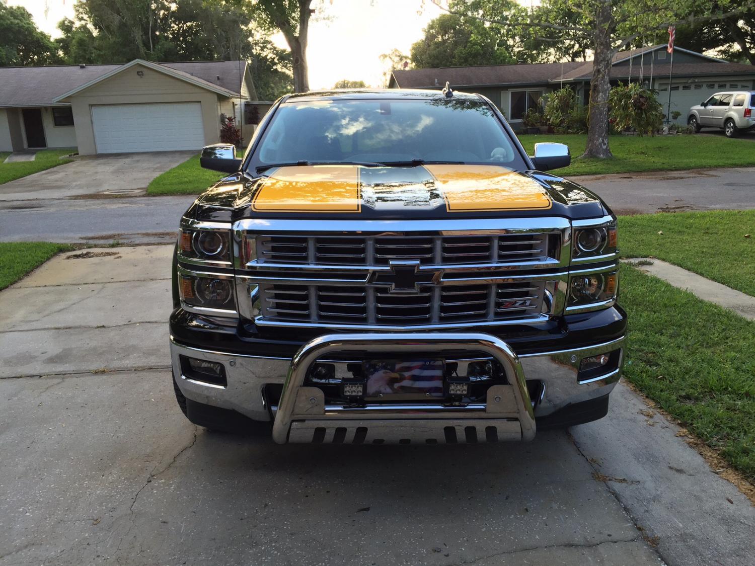

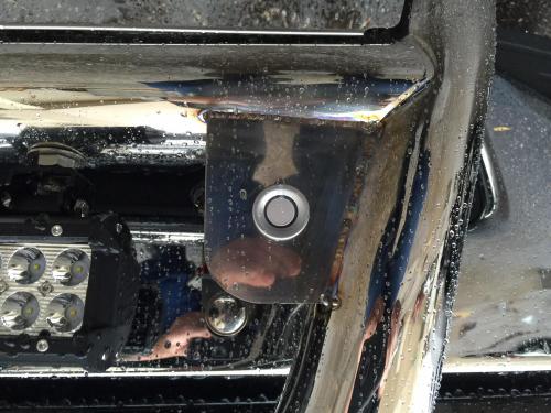

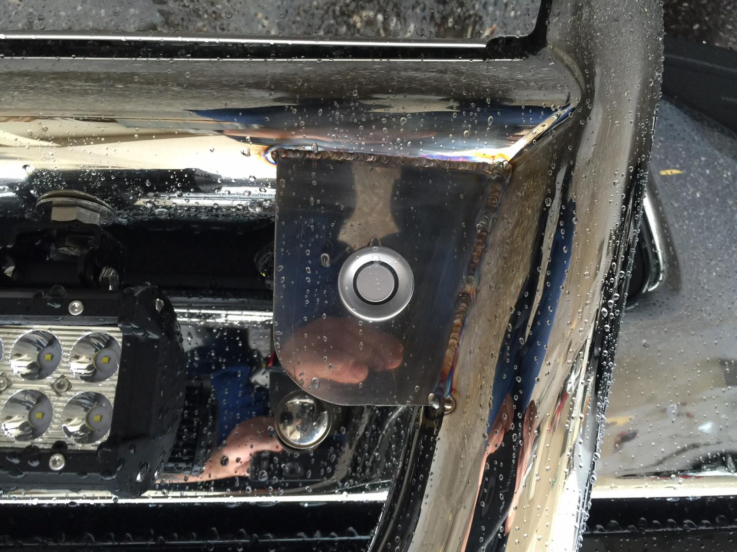

Put a stainless bull bar on my 2015 and I had plates welded in the corners. Them reinstalled the sensors in them.
They work great.
You can buy a complete new harness from Gm for 56.00. I used it and did this
Not finished yet but it works fine. Going to redo the housing. Good thing about stainless you can cut it off sand it polish it and looks like new. This was just a test to see if it would work. The wires where ran down the tubes and spliced to the harness with water proof red tab splices used on phone lines. So it will hold up longer than the truck.

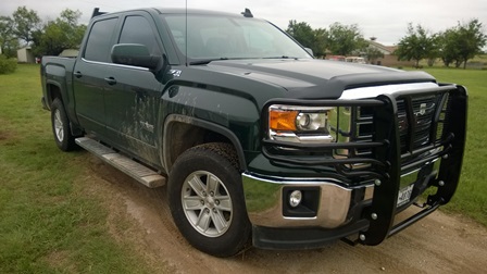

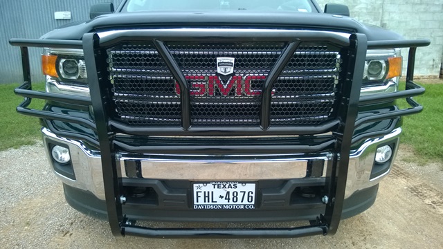

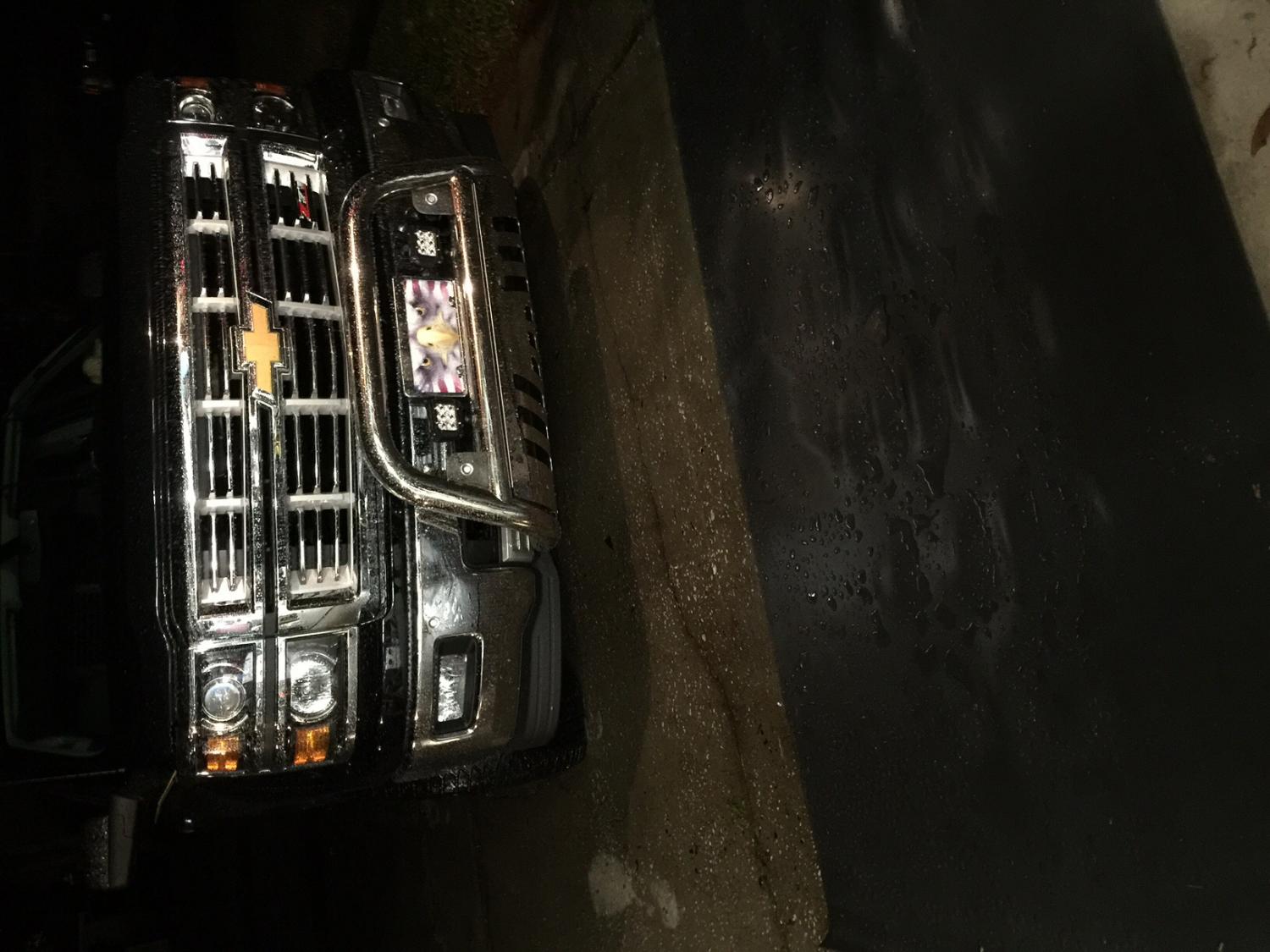

Here is the Cattleman HD grill guard on a 2015 Sierra. The install was super quick and easy. It didn't require removal of the grill or bumper pad. :driving:
