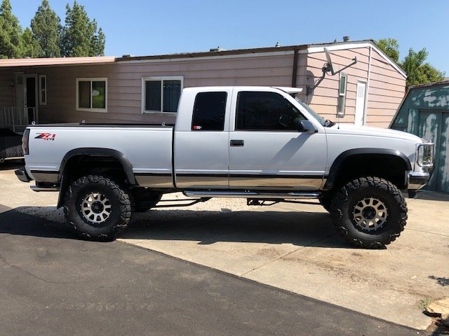

I have a 1996 GMC K-1500. A few years back the transmission went out so I went to AAmco and they replaced it with a newly rebuilt one. After 1 month, the trans went out so I went back to them and they replaced it again. Shortly after that, the engine went out and it sat for 3 years before I could fix it. Now, I am getting 3 different codes...P1860, P1864 and P1886.
The trans only has maybe 1000 miles on it, if even that... I'm guessing because of the time frame that has passed, AAmco won't touch it.
I will say that right after I got it back, the transmission seemed like it shifted really hard.. Almost like it had a shift kit in it, it does not.
It seems to shift fine, both up and down...
What might be my best course of action? I've recently put the truck up for sale. I've got over $30k into it and just want to get rid of it... It's a great truck...
Also, it is lifted about 6 inches and it has 37's on it. I know that's causing quite a bit of drag on the trans, but I never beat it or get on it at all... Like I said, it baely has 1000 miles on the second rebuilt AAmco trans...
Should I even bother calling them to see if there's anything they can do? Obviously it is a problem with the trans they sell.
