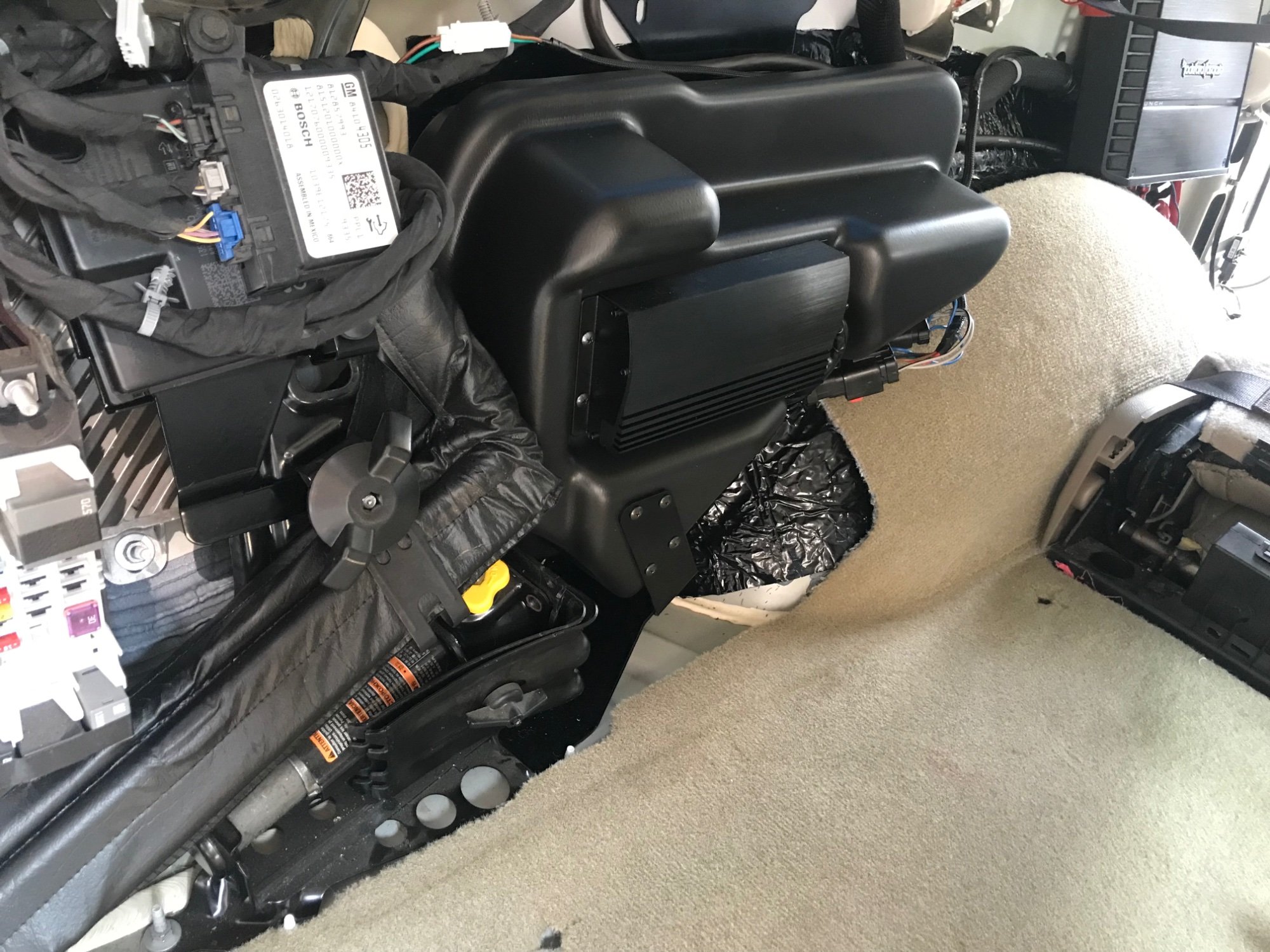

I added the GM Factory Kicker Sub upgrade that created a rattle in the rear left. I checked the jack and other potential loose items/clips... At the time of original install I also added sound deadening mats to all the body panels in the vicinity- later I actually thought maybe I got as defective sub or maybe it's already blown so that's why it sounds rattle-eeee ...I called Kicker, they offered to warranty it out no questions no hassle... they have a standard 3 year 36k from date of sub purchase. When I got it out I tried duplicating the sound, no rattle and sub didn't sound blown... so instead of warranting it out I reinstalled it and tried shimming the top right bracket away from the metal body. My shim was about a half inch... worked for me. No more GM integrated Kicker sub rattle...
 final note... and one I didn't see mentioned in the thread... check the cup holders I've experienced this simple and silly problem of something being left in a rear cup holder causing rattle. Photo is for illustrative purpose. Rear quarter trim panel has since been reinstalled.
Edited by ScottD1970
clarify where the shim is and point out that rear trim panel is removed for illustrative purposes (i'm not driving around without the trim panel on! although that would eliminate potential rattle! less stuff in the vehicle = less stuff to rattle :)
