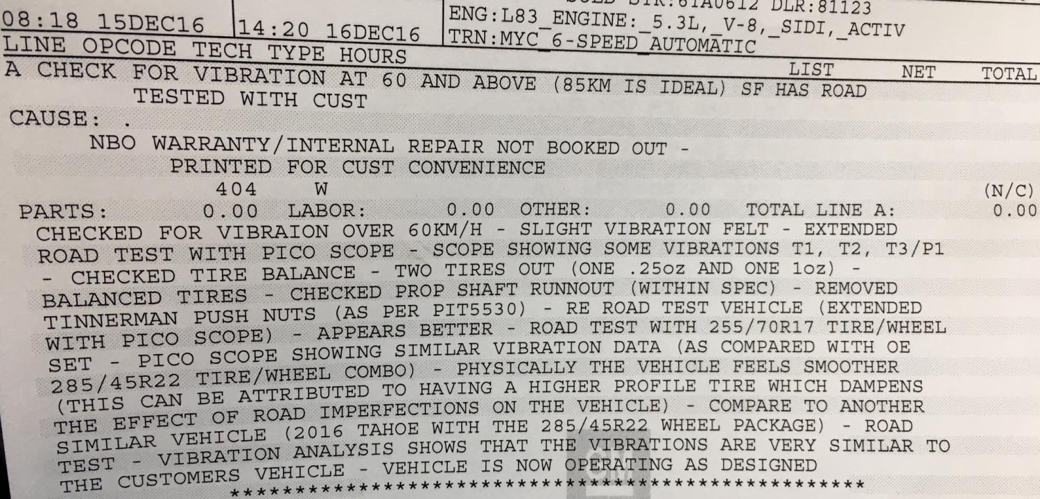

Quick update on my vibrating Tahoe,
Truck was sitting at dealer for 2 full days. At the end their conclusion is pretty much what I expected - 2 tire were out of balance, and they simply rebalanced them.
Here is my service record.
Well, at least I know there is no issue with the drivetrain. I guess this s the worst viechle design combination on the world: K2xx+22wheel+bridgestones!
Already paid so mich money for a vibrator, I just can't waste more time on this thing. This is a brand new truck after all. Now I am at a tire shop and getting the Mechelin installed. Let's see how it goes.post-166068-0-18165500-1481997579_thumb.jpg
Edited by tonywush
Okay, so after swapping the bridgeSTONE with Michelin, the truck now performs SO SO SO MUCH BETTER. It is so much smoother on the highway now. No more massage seat and steering wheels. I'd say 90% of the vibration is gone now. I blame the remaining 10% of the vibration is just because of the combination of the body-on-frame chassis and 22 inch wheels. Anyway, I am very happy with the truck now and accept this is a vehicle that is "operating as designed".
