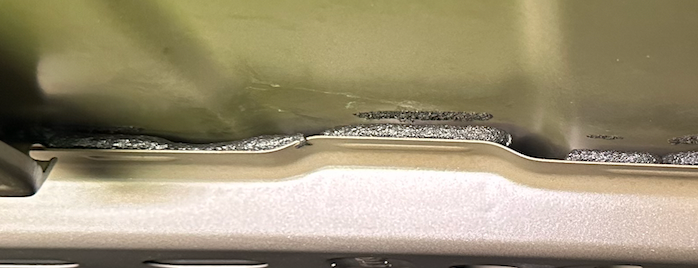

hate to resurrect this thread but GM I swear,
my 21 suburban has major booming Buffeting, the booming itself would happen even from closing the driver door. That's when I discovered the roof was fluttering on the outside bad every time I closed the door.
My car is out of warranty, pulled the headliner down to discover roof bows were not attached. GM is an absolute joke that they still didn't fix this!!
IT was like this on all 5 cross bows, NON OF THEM WERE ATTACHED you can see the mark on the ceiling the gap and then foam I got the flexible foam from 3m to fix it, and sound deadend the roof which helped a lot but still slightly flitters causing booming in the vehicle, im so annoyed!!!
